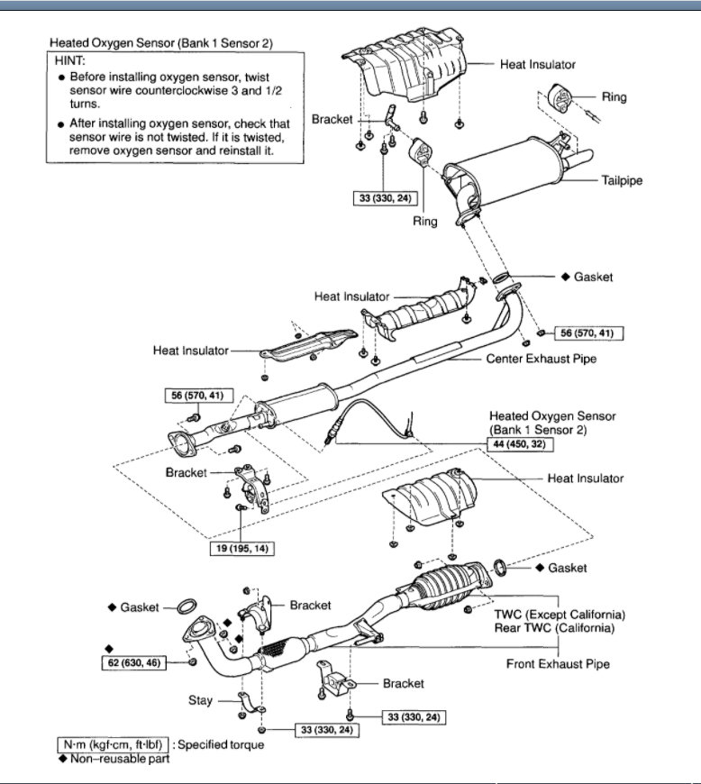

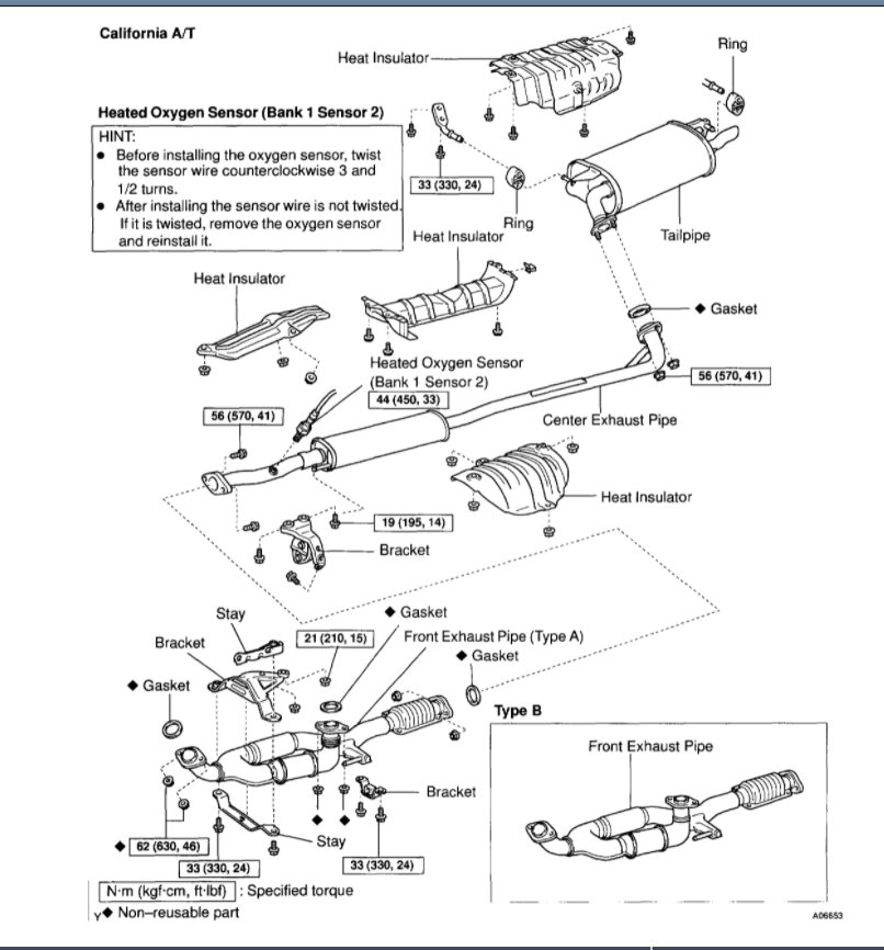

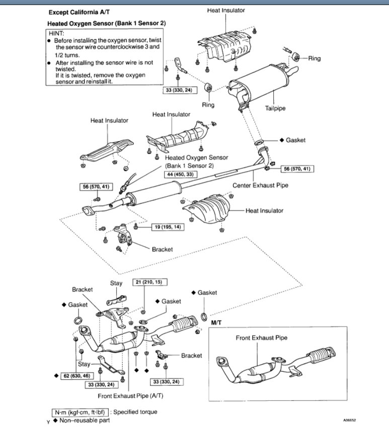

Please find the info from the manual that will show the connection points and torque specs to get it replaced.
Based on this info I think they are correct but running through this info should help confirm this.
