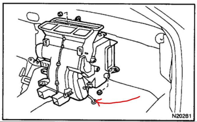

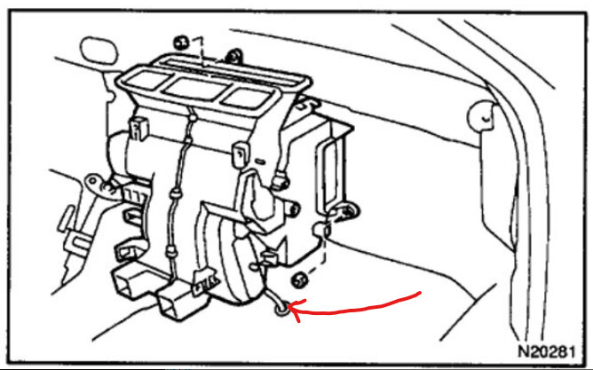

Air Conditioning problem 4 cyl Two Wheel Drive Automatic 215000 miles
I have water in the floorboard. The right rear passenger side is the worst. It seems that condensation from the AC may be the culprit. Where is the A/C drain line so I can see if it is clogged. How would I unclog it.
Thanks
May 30, 2010 at 9:42 AM
  • 55,423 POSTS
The location of the air conditioner condensation tube is on the passengers side near the fire wall under the car. Here is a diagrams (Below).
