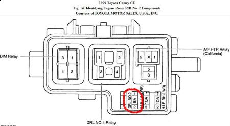

my car head light opening just i drive it i wnat close that lught during the day

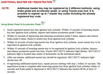

another plz how i can programing the new key bye the master key

Hi aziz8, Thank you for the donation. Vehicle is equipped with Daytime Running Lights and to diasable it, remove the underhood Relay Box #2 DRL No 2 fuse ( 5 A ). Here are the procedures for registering additional master keys.

thanks this step i want to see picture for this

I was supposed to attach the diagram but missed it out. Sorry for the mistake. In diagram Fuse #2 is listed as 15 A.

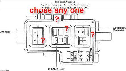

thanks mr khalo please notes that there are more than No. 2 fuse chose any one to be on the left or the right and center to the cover 15 shown i mean daylight how i can close it u send picture for that but i cant know any one :

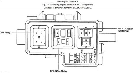

Sorry for not being clear. Those numbers that you marked are terminal locations for relays and are not fuses.
