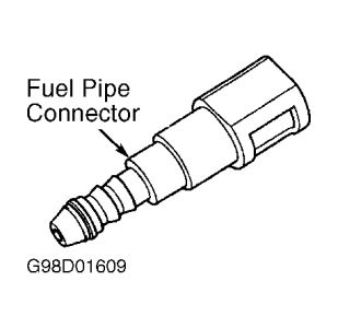

And, there is no dedicated fuel system tap to check fuel pressure. The only connection point seems to be at the fuel filter, which has a crazy plastic pipe/oring connection. I'm guessing you need a specific adapter to check fuel pressure, and isolate the injectors from the regulator to check for leak down. The car does seem like it is flooded when it starts, so injector lea kdown could be the issue....
I finally gave in, and brought the car back to the dealer to let them check the pressure. I will replace the injectors again if they feel the "re-manufactured injectors" I installed are leaking down....The car seems to run/idle fine once started, and there is no check engine warning, which is why I suspected a IAC problem. But anything is possible. Please let me know if there is a reasonably priced fuel pressure test adapter kit for this car. I will let you know what the dealer finds....

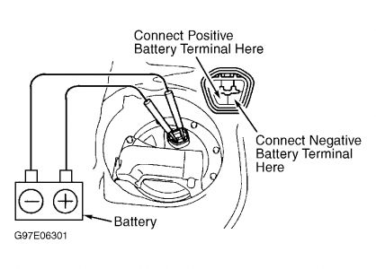

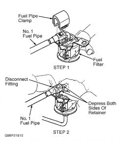

Well, I would have looked at the regulator, especially if it's a hard start after a soak. The adapter is available at Toyota parts, I dont think it's too expensive, No there is no cold start injector on yours, a gauge is available here at a reasonable price. Installing Fuel Pressure Gauge (Avalon, Camry & Camry Solara)
https://images.2carpros.com/forum/automotive_pictures/62217_Pipe_1.jpg
https://images.2carpros.com/forum/automotive_pictures/62217_pipeb_1.jpg
https://images.2carpros.com/forum/automotive_pictures/62217_pump_3.jpg

Thanks so much for your detailed explanation concerning checking fuel pressure. I took the car back to the dealer today to have them replace the "flex pipe" and paid them to check out the fuel pressure. I got your reply tonight after returning from the dealer.
The running pressure was within book specs, and the leakdown (after shutting the engine off), did not exceed book specs either. The technician gave me a copy of the svc manual page describing the procedure, and his results. So, I am reasonably confident that the injectors are not leaking down flooding the engine. The dealer did not look into the hard start symptom any further due to time constraints....So, I have the car back again, it is quieter, but starts only after excessive cranking.
Thank you for supplying the pressure test adapter number, I will order one from the dealer...

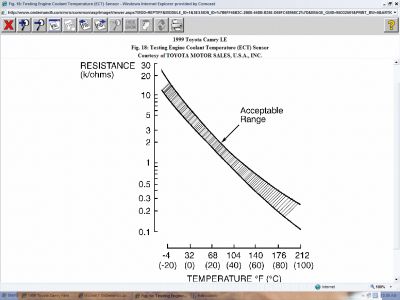

I surely understand how the ECT could be causing a problem. I also understand why there is no check engine light if the sensor is "not out of range". I will look in the manual to see if I can find some cold/hot resistance readings for the ECT (I don't have a scan tester).

Heres the range chart for the ECT.
https://images.2carpros.com/forum/automotive_pictures/62217_ECT_8.jpg

Thanks for the graph, I check the ECT cold, was about 3000 ohms, hot was about 200 ohms...So, that seems to say there is no problem with the ECT.
