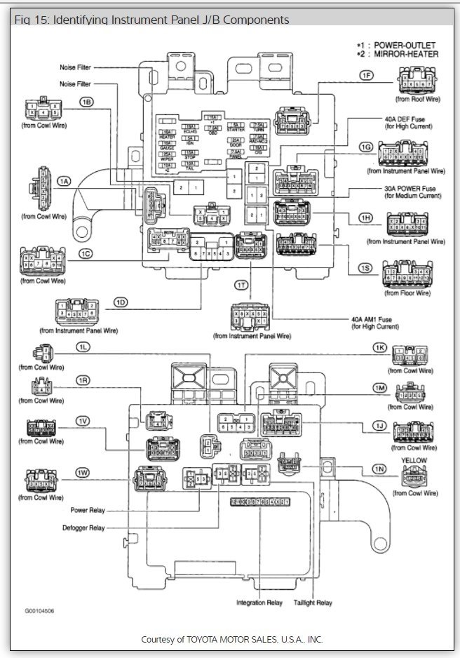

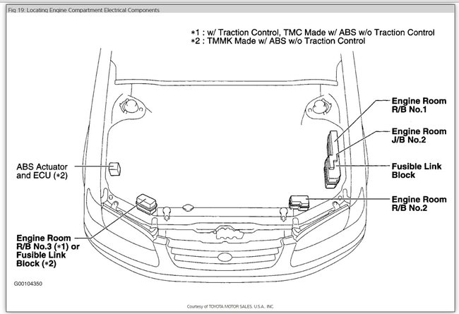

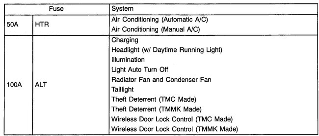

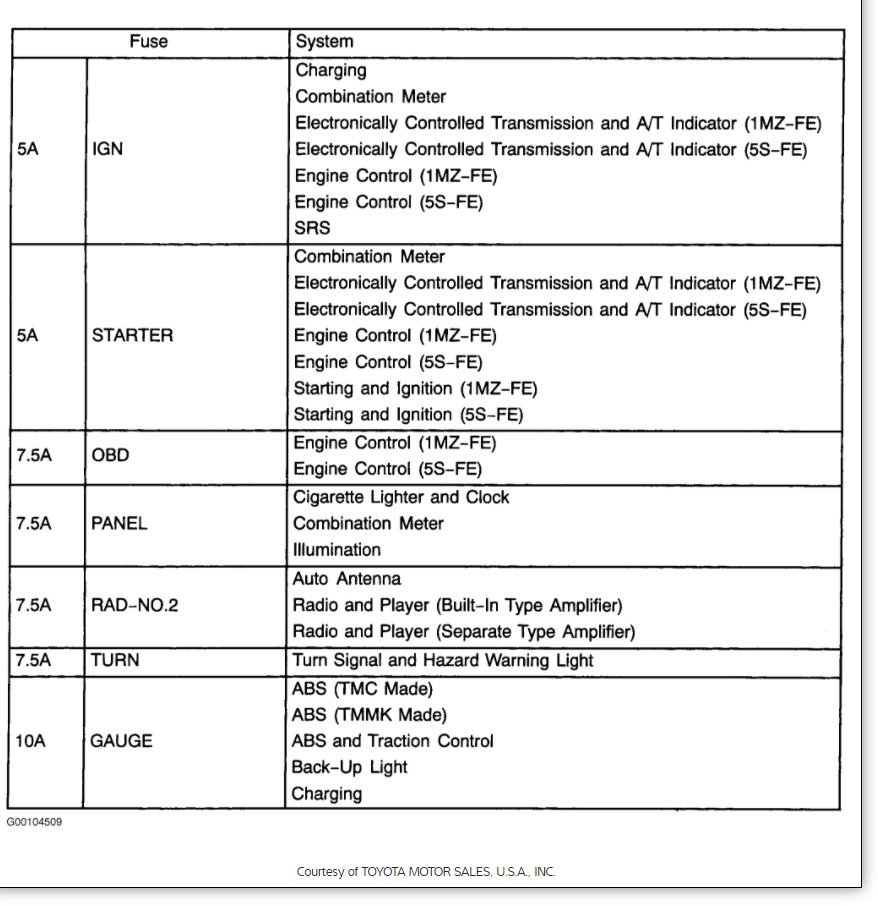

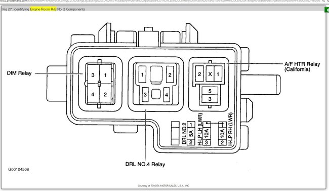

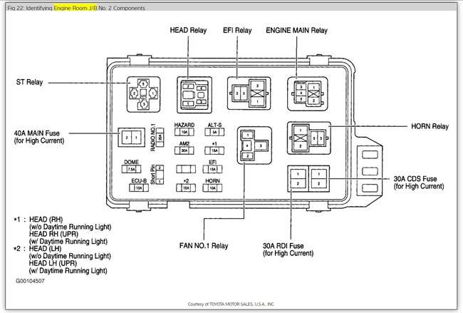

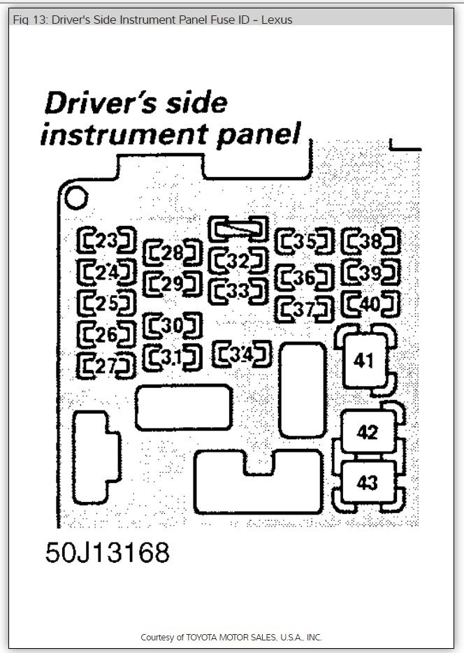

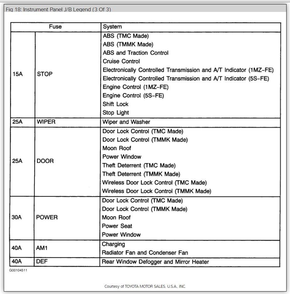

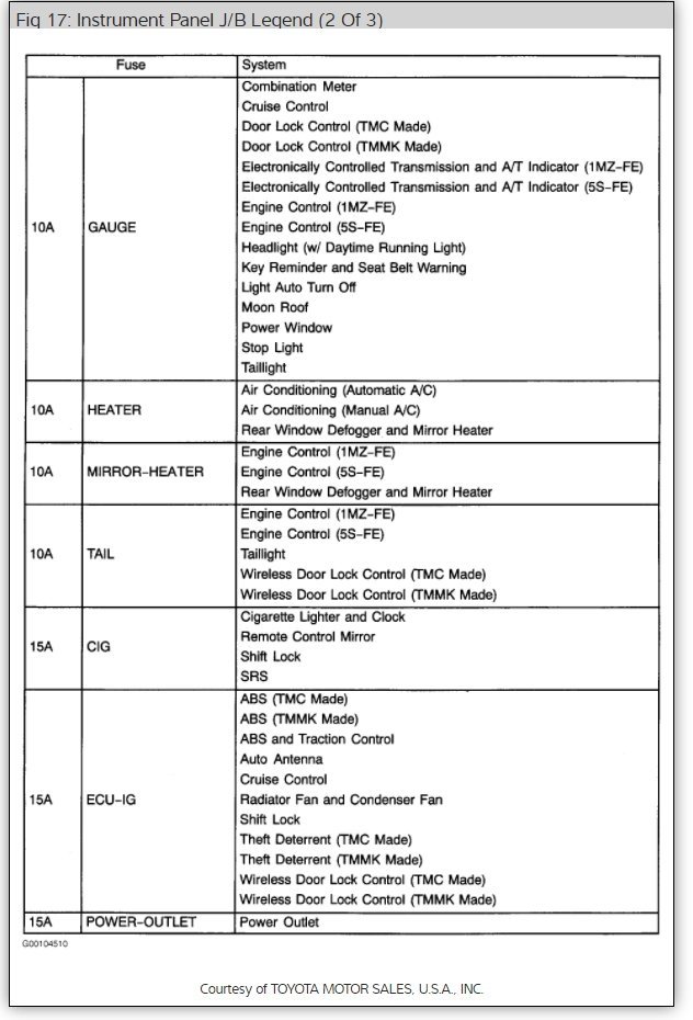

I found the fuse box under the hood of my car but I have no lights on the instrument panel for my speedometer or gear shift. Is there a fuse box inside of the car that takes care of this? My radio and clock works fine.
Thanks,
Helen
Jul 27, 2008 at 11:01 AM
  • CAR REPAIR CONTRIBUTOR
  • 54,369 POSTS

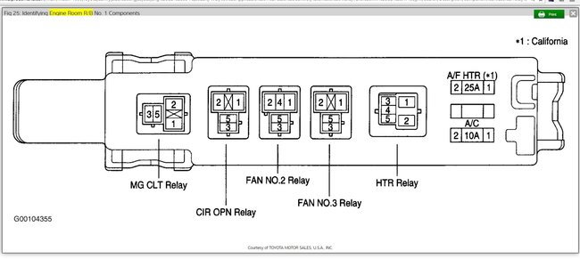

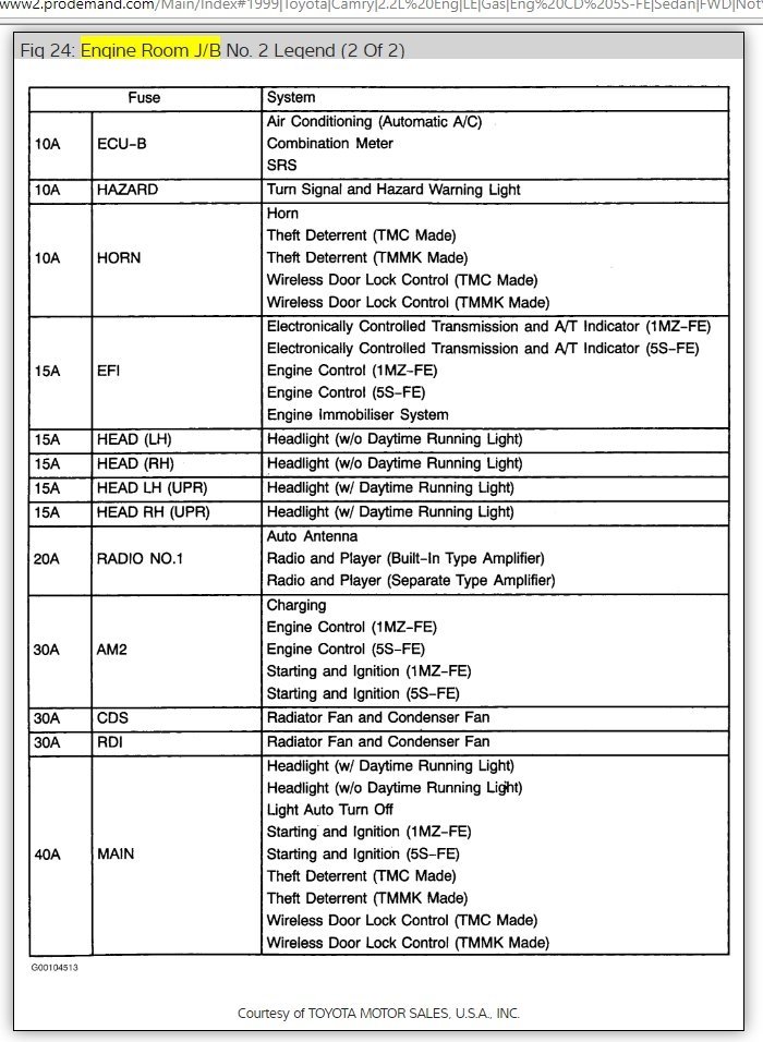

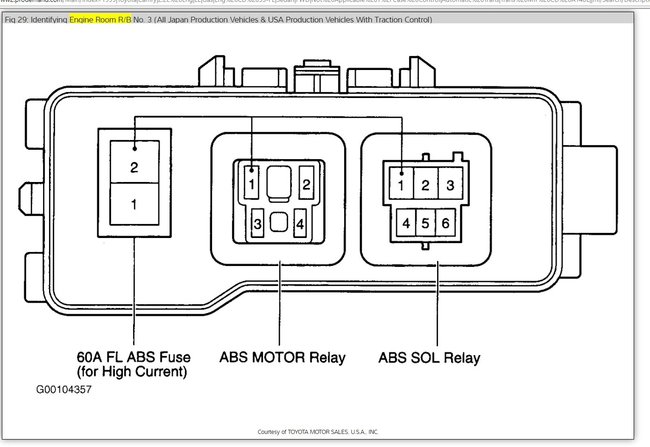

I have found the fuse panel location along with the relay locations (below) Here are some guides to help you do some testing so you can get the car fixed.
and
and
