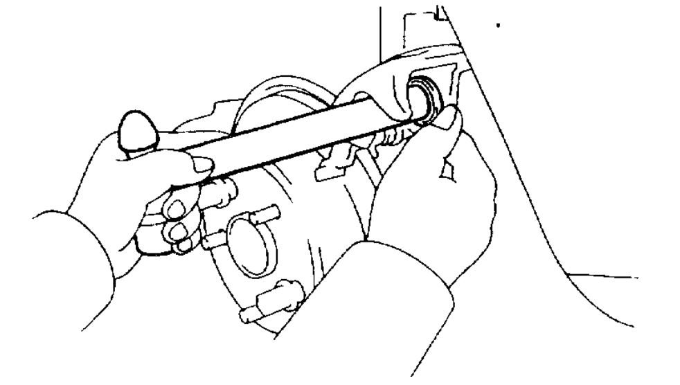

Does the rear brake piston compress with a clamp, or do you need a reset tool?

No, the piston just pushes back. I attached the procedure and some pictures for you.
https://www.2carpros.com/articles/how-to-replace-rear-brake-pads-and-rotors

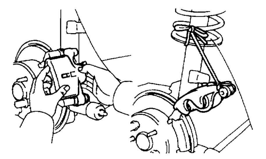

3. LIFT UP CALIPER
a. Remove the bolt and flexible hose from the bracket.
b. Remove the installation bolt from the torque plate.
c. Lift up the caliper and suspend it securely.
HINT: Do not disconnect the flexible hose.

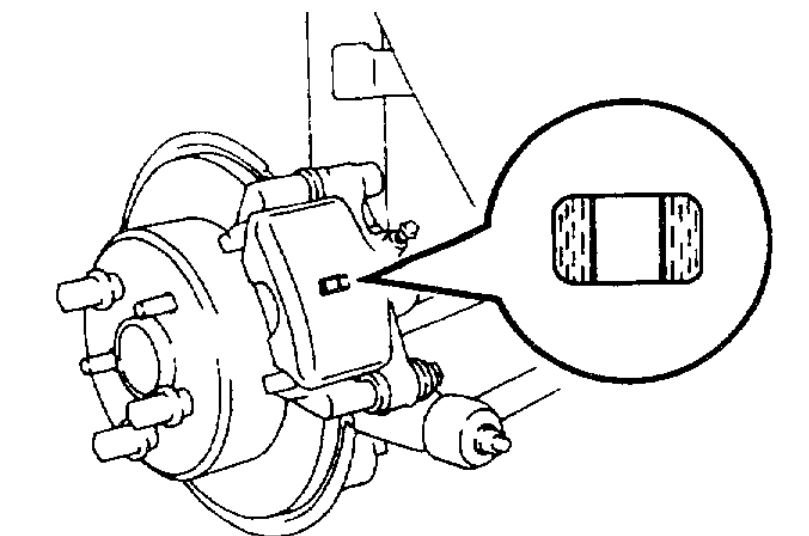

9. INSTALL NEW PADS
NOTICE: When replacing worn pads, the anti-squeal shims must be replaced together with the pads.
a. Apply disc brake grease to both side of the inner anti squeal shims.
b. Install the 2 anti-squeal shims on each pad.
c. Install 2 pads with the pad wear indicator plate facing upward.
NOTICE: There should be no oil or grease adhering to the friction surfaces of the pads or the disc.
10. INSTALL CALIPER
a. Draw out a small amount of brake fluid from the reservoir.
b. Press in the piston with a hammer handle or similar implement.
HINT: If the piston is difficult to push in, loosen the bleeder plug and push in the piston while letting some brake fluid escape.
c. Install the caliper and torque the installation bolt.
