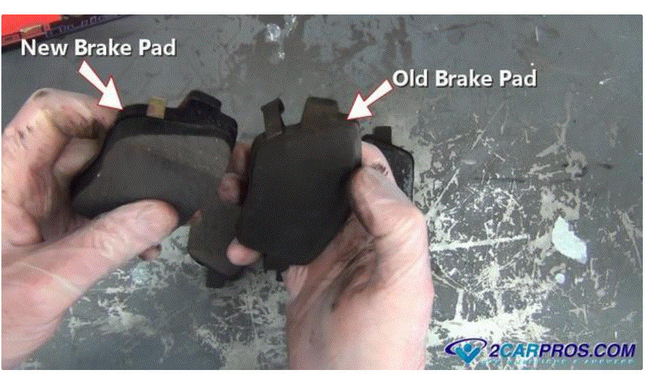

Check the brake pads to confirm they are worn. If you look at pic 1, it compares worn brake pads with new ones.

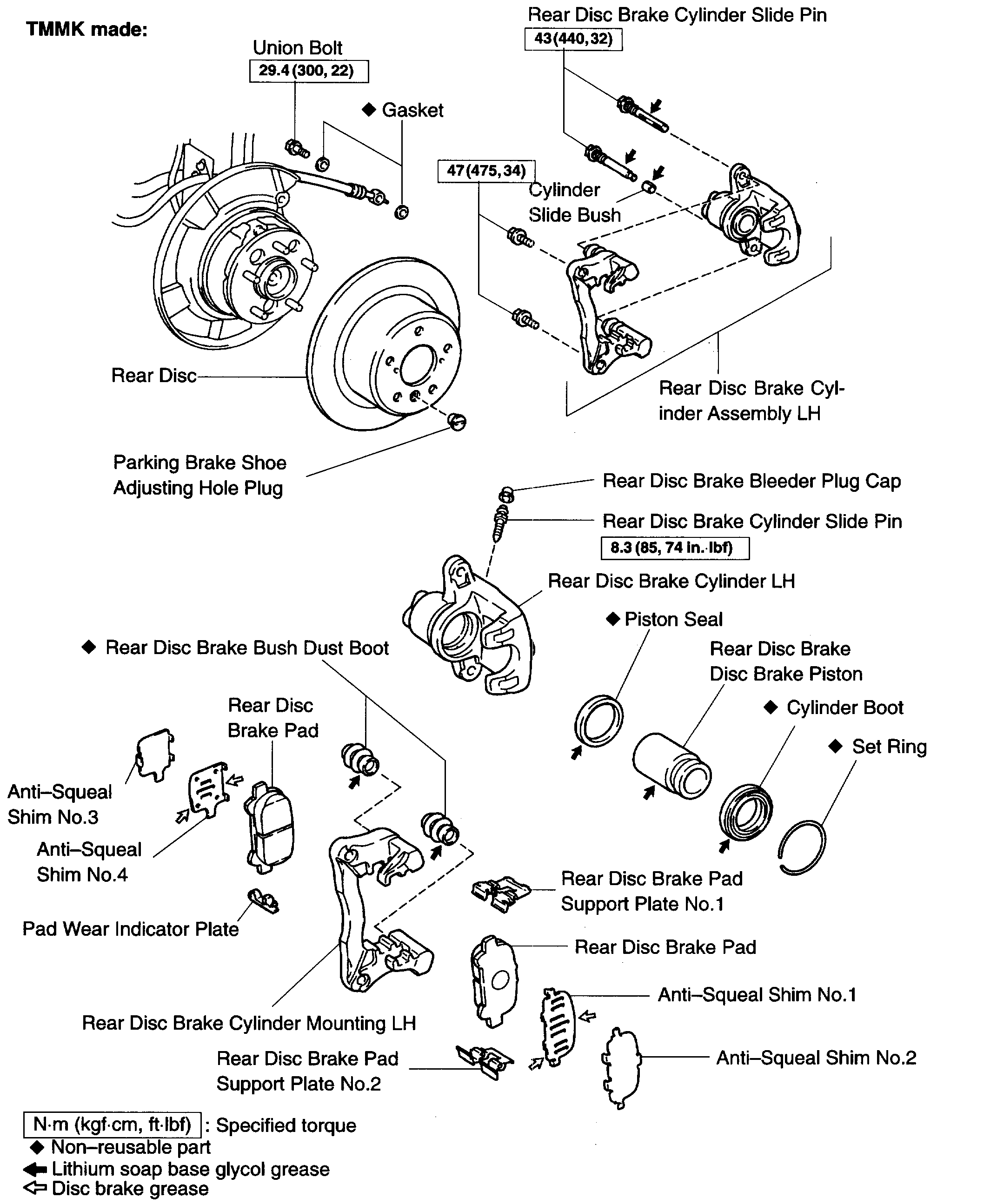

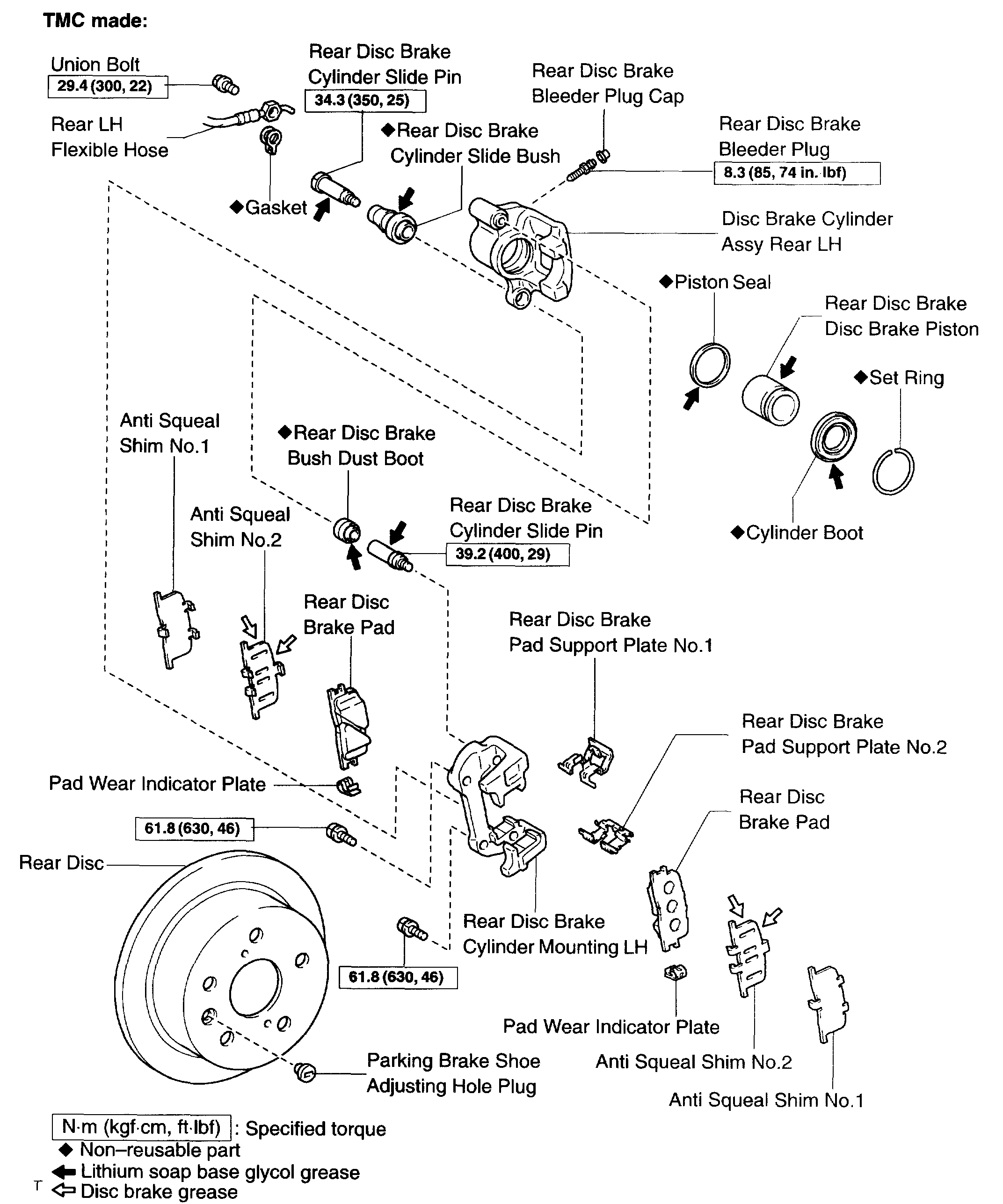

Here are the directions specific to your vehicle. The attached pics correlate with the directions.
_______________________________
The directions include how to check a rotor and overhaul a brake caliper. You can bypass what isn't needed.
2004 Toyota Camry L4-2.4L (2AZ-FE)
Rear
Vehicle Brakes and Traction Control Disc Brake System Service and Repair Procedures Rear
REAR
pic 2
pic 3
OVERHAUL
HINT:
^ Overhaul the RH side by the same procedures with LH side.
^ Two types of brake pad exist; one is with slit and the other without slit.
1. REMOVE REAR WHEEL
2. DRAIN BRAKE FLUID
NOTICE: Wash off the brake fluid immediately if it comes into contact with a painted surface.
3. DISCONNECT REAR LH FLEXIBLE HOSE
a. Remove the union bolt and a gasket from the disc brake cylinder, then disconnect the flexible hose from the disc brake cylinder.
HINT: Gasket has 2 types: 2-piece type and 1-piece type.
4. REMOVE REAR DISC BRAKE CYLINDER SLIDE PIN
a. TMC made: Remove the cylinder slide pin.
b. TMMK made: Remove the cylinder slide pin and cylinder slide bush.
5. REMOVE DISC BRAKE CYLINDER ASSY LH
a. TMC made: Lift up the disc brake cylinder and remove the disc brake cylinder.
b. TMMK made: Remove the cylinder slide pin and disc brake cylinder.
6. REMOVE DISC BRAKE PAD KIT REAR (PAD ONLY)
a. Remove the 2 brake pads with the anti-squeal shim.
7. REMOVE REAR DISC BRAKE ANTI SQUEAL SHIM KIT
a. Remove the 2 anti-squeal shims and pad wear indicator from each of 2 brake pads.
b. TMC made: Remove the 2 pad wear indicator plates from each of 2 brake pads.
c. TMMK made: Remove the pad wear indicator plate from inner pad.
8. REMOVE REAR DISC BRAKE PAD SUPPORT PLATE
a. Remove the rear disc brake pad support plate No. 1.
9. REMOVE REAR DISC BRAKE PAD SUPPORT PLATE
a. Remove the rear disc brake pad support plate No. 2.
10. REMOVE REAR DISC BRAKE BUSH DUST BOOT
a. TMC made: Remove the rear disc brake bush dust boot.
b. TMMK made: Remove the 2 rear disc brake bush dust boots.
11. REMOVE REAR DISC BRAKE CYLINDER MOUNTING LH

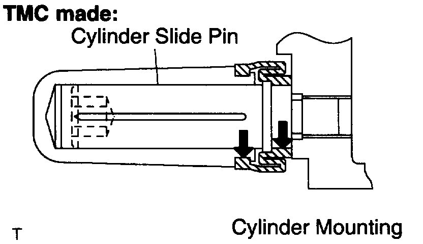

a. TMC made: Using a hexagon wrench ([diameter]8 mm),remove the cylinder slide pin.
b. Remove the 2 bolts and cylinder mounting LH.
12. REMOVE CYLINDER BOOT
a. Using a screwdriver, remove the set ring and disc cylinder boot.

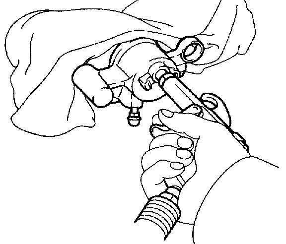

13. REMOVE REAR DISC BRAKE DISC BRAKE PISTON
a. Place a piece of cloth or similar, between the piston and the disc brake cylinder.
b. Use compressed air to remove the piston from the disc brake cylinder.
CAUTION: Do not place your fingers in front of the piston when using compressed air.
NOTICE: Do not spatter the brake fluid.

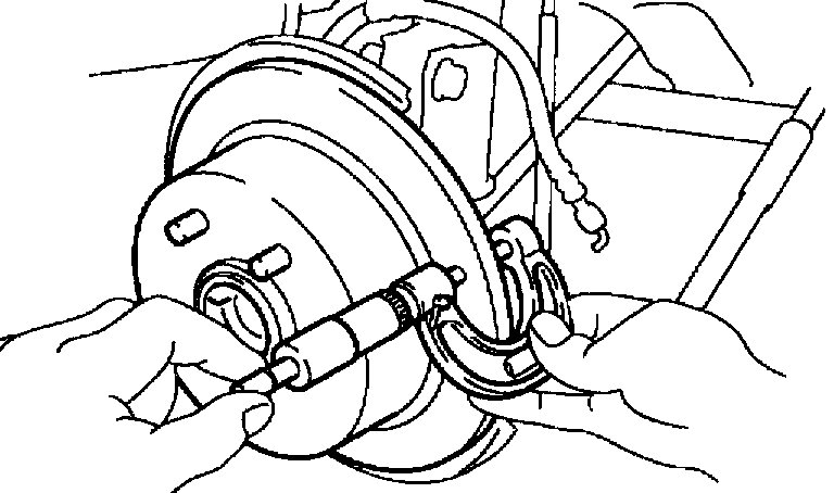

21. INSPECT DISC THICKNESS
a. Using a micrometer, measure the disc thickness.
Standard thickness: 12.0 mm (0.472 inch)
Minimum thickness: 10.5 mm (0.413 inch)

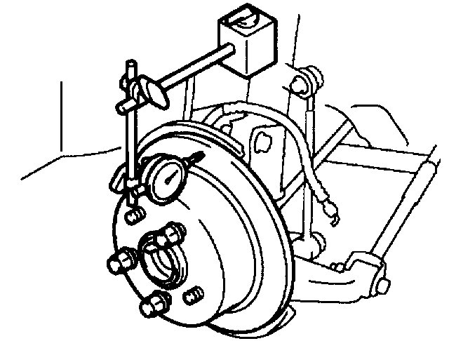

26. INSPECT DISC RUNOUT
a. Temporarily fasten the disc with hub nuts.
Torque: 103 Nm (1,050 kgf-cm, 76 ft. lbs.)
b. Using dial indicator, measure the disc runout 10 mm (0.39 inch) away from the outer edge of the disc.
Maximum disc runout: 0.15 mm (0.0059 inch)
c. If the disc's runout is maximum value or greater, check the bearing play in the axial direction and check the axle hub runout. If the bearing play and axle hub runout are not abnormal, adjust the disc runout or grind it an "On Car" brake lathe

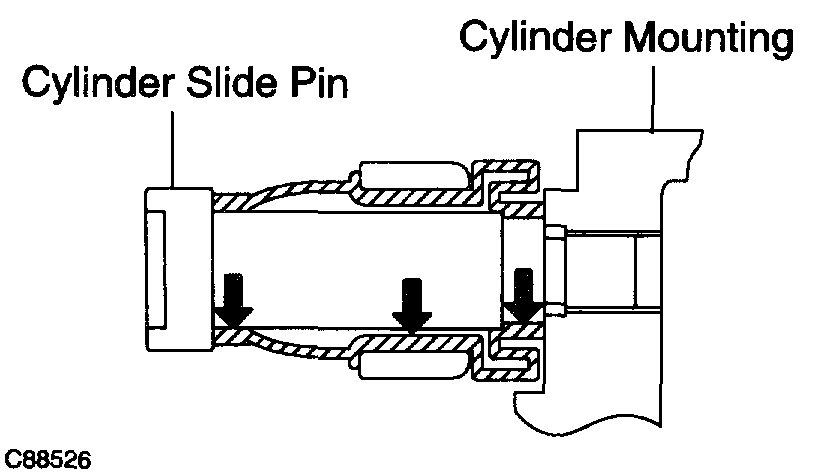

34. INSTALL REAR DISC BRAKE CYLINDER SLIDE PIN
a. TMC made: Using a hexagon wrench (8 mm), install the cylinder slide pin.
Torque: 39.2 Nm (400 kgf-cm, 29 ft. lbs.)
b. TMMK made: Install the cylinder slide pin with the cylinder slide bush.
Torque: 43 Nm (440 kgf-cm, 32 ft. lbs.)
pic 7
35. INSTALL REAR DISC BRAKE CYLINDER SLIDE BUSH (TMC MADE)
a. Apply the lithium soap base glycol grease on a new cylinder slide bush.
b. Install the cylinder slide bush to the disc brake cylinder assy.
