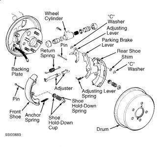

1999 Toyota Camry 4 cyl Two Wheel Drive Automatic
How to replace rear brakes
Nov 22, 2009 at 3:57 AM
BMRFIXIT
  • 19,053 POSTS
Raise and support vehicle. Remove wheel and tire assembly. Remove brake drum. Disconnect return spring from front shoe. Remove front shoe hold-down spring, cup and pin. Remove anchor spring from front shoe, and remove front shoe. Remove anchor spring from rear shoe. Remove rear shoe hold-down spring, cup and pin. Disconnect parking brake cable from lever. Remove rear shoe, adjuster and levers as an assembly. Remove adjusting lever spring. Remove adjuster and return spring from rear shoe. Remove "C" washers, adjusting lever and parking brake lever from rear shoe. Installation Install adjusting lever and parking brake lever to rear shoe with NEW "C" washers. To complete installation, reverse removal procedure. Apply non-melting grease to sliding surfaces of shoes and adjuster threads. Check and adjust rear brake shoe clearance
