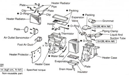

When the AC is on water is leaking inside the car on both sides. How do you get to the drain? what would cause this? Thanks John

Check drain hose in the picture. Located between the driver/front passenger footstep. Maybe it got unplugged or hose got in inside the car, should go outside underneath the car.
