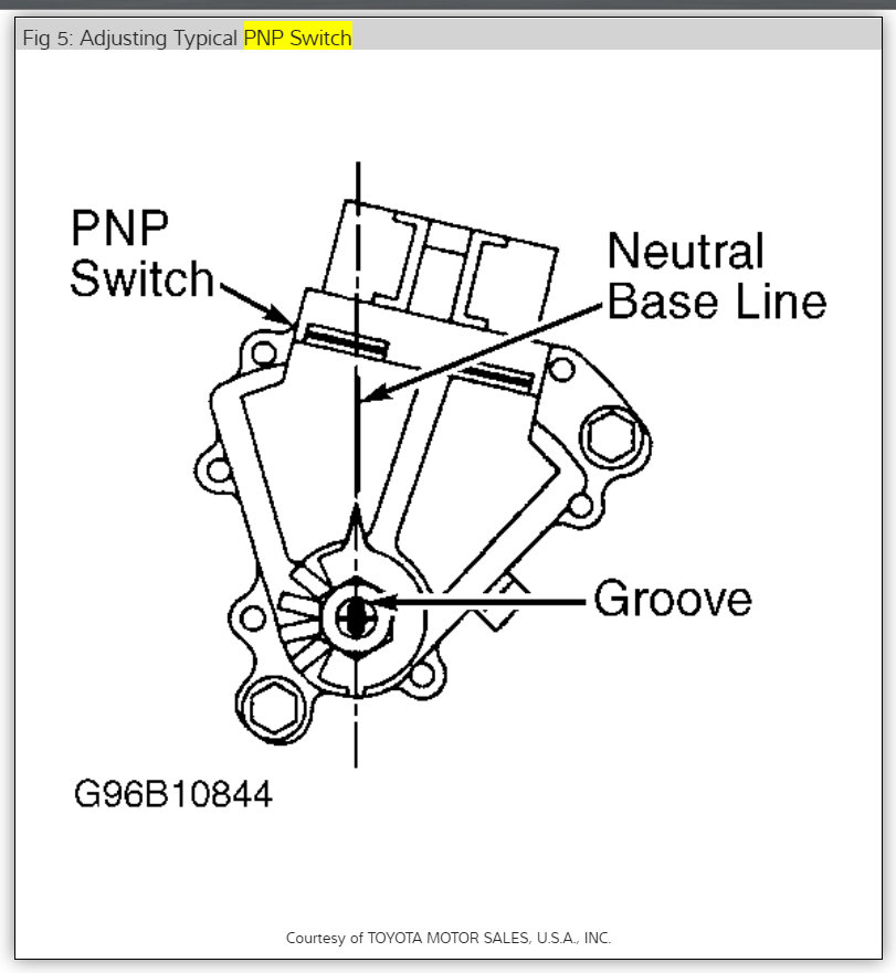

Engine Mechanical problem 4 cyl Two Wheel Drive Automatic 200000 miles

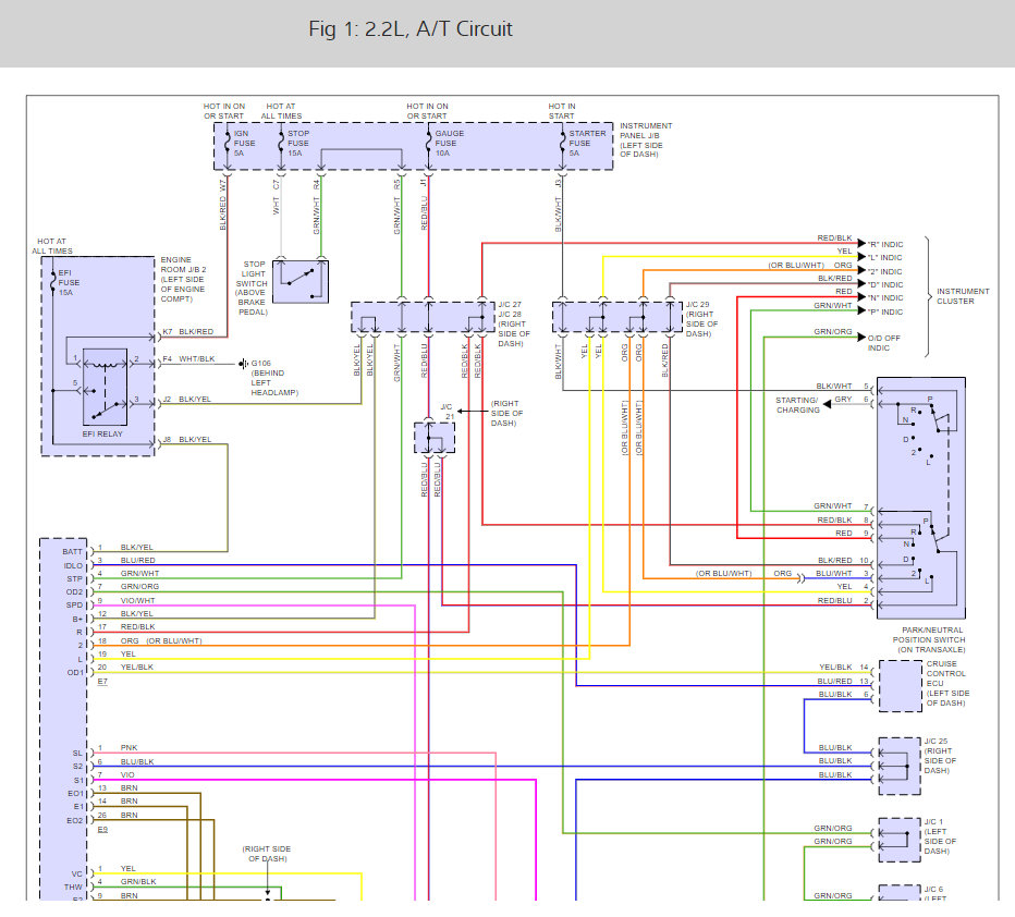

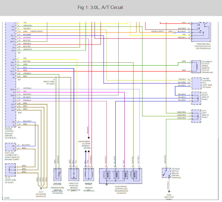

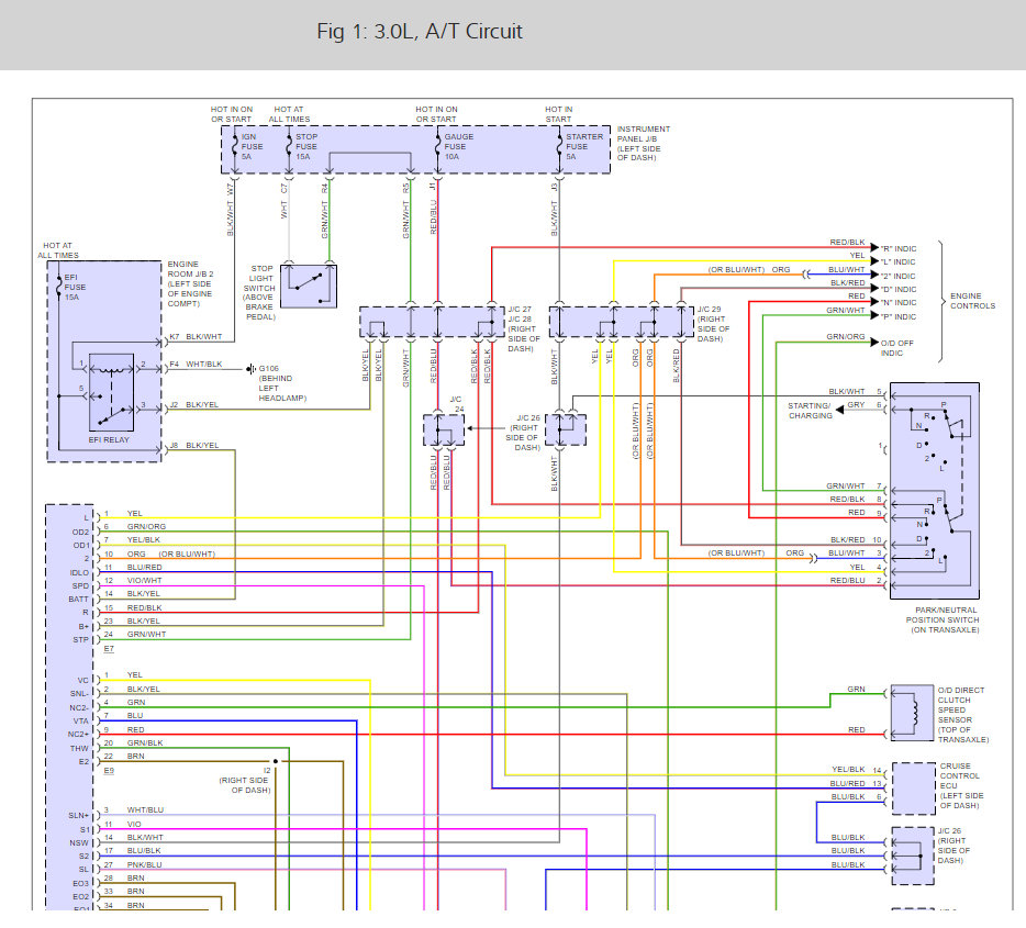

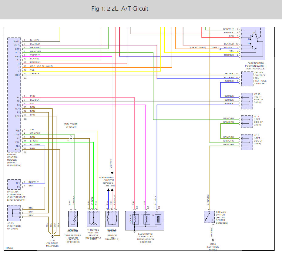

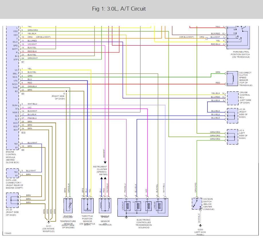

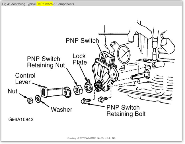

My car won't go forward when put in drive or any of the lower gear. Will go in reverse when in reverse gear. I do not know what the problem is. Try refill transmission fluid. Don't know what else to do. Thank you. Any light on the subject would be greatly appreciated.
Oct 5, 2010 at 10:30 AM
  • 55,256 POSTS
It sounds like you have a gear selector potions switch that is out. But to be sure lets do some easy testing. Here is a guide and some diagrams (Below) on how to do the job. There are some system fuses that should be checked as well.
Here is the transmission and transmission range sensor wiring diagrams so you can check it out to confirm the failure and get it fixed.
https://www.2carpros.com/articles/how-a-neutral-safety-switch-works

Are you able to move in reverse?
Does shifting to L works?
Seems the trans is bad. Previously when you were not getting good acceleration, the trans should be stuck either in 2nd or 3rd and this would cause the trans to strain when taking off under load. The clutches have been damaged and you would need a rebuilt or replacement.

Yes, that can be due to faulty forward clutches.
Here is a description of the removal procedure.
