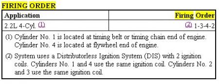

I removed the spark plug wires and do not know the order that they go back on. There are 4 plugs and I need to know from left to right(facing the windshield while looking under the hood of the car) how they connect to the rotor? Which has four plug in ports running verticle from the bumper to the windshield.

https://www.2carpros.com/forum/automotive_pictures/30961_fir_2.jpg

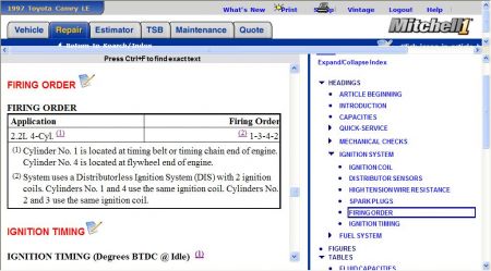

See below
https://www.2carpros.com/forum/automotive_pictures/12900_fo_16.jpg
