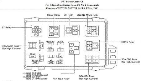

All of sudden my interior door light stopped working with my remote. Now I have noticed my clock is blinking all the time. I did realize that clock time is not syncing means getting little back as of standard time.
Had install new cell of my remote still no luck. Just a note I had installed battery around three years ago and no problem with starting the car or with front lights..
Need help please!
Ron

Hi ron1111, Check the dome fuse in under hood fuse box.
https://images.2carpros.com/forum/automotive_pictures/192750_JB2Hood97CAmry_1.jpg

HI KHLow2008,
Thanks for the help it really worked well. But next day same problem and I think fuse went bad again.
Not sure what is going on.
Please advise
