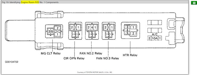

I have a Toyota Camry and i recently purchased a ac relay because my compressor will not engage. I looked in both fuse boxes and under the hood but i cant find it. could you please tell me the location of the relay.

The air conditioner compressor relay is located under the hood in the power distribution box. Here is a guide to help you change the relay which is called the MG CLT relay:
Here is the relay locations. Check out the diagrams (below). Please let us know if you need anything else to get the problem fixed.
