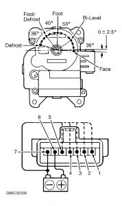

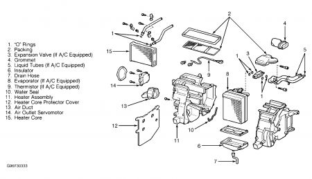

1997 Toyota Camry 1997 Toyota Camry no heat
PHLK5
  • 1997 TOYOTA CAMRY
  • 4 CYL
  • FWD
  • 120,000 MILES
My air conditioning works fine and I cant find any fuses that are blown. I can't even get any engine heat through the floor vents. The car doesnt over heat when driving. I believe it may be an electrical problem because my dome light doesnt work either.
Wednesday, December 3rd, 2008 AT 7:47 AM

PHLK5
I just checked there is no sound whatsoever when I switch from hot to cold or vice versa.

RACEFAN966
  • 5,029 POSTS
Ok it sounds like the air outlet servomotor might be bad. Here is a view of the hearter and a/c components and number 14 is were the servo motor is this is what needs to be checked to see if it is working.
https://www.2carpros.com/forum/automotive_pictures/249564_Graphic_13.jpg
Now you need to unplug the harness from the servomotor ok. you will apply voltage to pin 6 using a jumper wire, now connect pin 7 to ground. Now with another jumper wire connect pin 5 to ground and it should go to defrost, then put it to pin 4 should be mix, pin 3 should go to floor, pin 2 should be bi-level, pin 1 should be vents or face. So as you switch the last jumper wire from those above pins it should change where the air flows if it doesn't then the servomotor is bad and needs replacement. If you have any questions please just ask ok. Here is a pic of the pins and there numbers ok.
