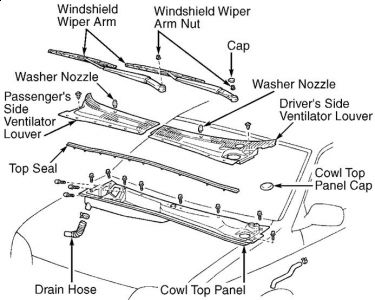

My windshield wipers aren't working. I left them turned on this winter when there was a heavy snowfall on my windshield. Now when I turn them on I just hear thunking and thudding and nothing happens. I checked the fuse and it is fine. What do you think my problem is?

https://images.2carpros.com/forum/automotive_pictures/55316_96camrywiper_1.jpg
Check the tightness of the wiper arm nuts.
