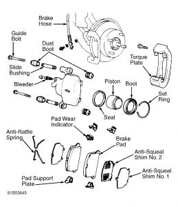

My brakes seem to be wearing more on the drivers side. I need to change the brake pads but I may need to replace the front drivers caliper.I know somewhat how to do it but it has been a while.

Remove caliper as per pic & text, the only extra thing to do is get a brake hose clamp and close off the brake hose when you undo the hose banjo bolt at the caliper, don't loose the 2 copper washers on the bolt one on the top and the bottom.
