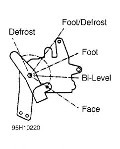

The AC/heater works and fan blows however the air deflection positions have suddenely stopped controlling air flow to the various vents. The push button contols light up and click when pressed but nothing changes in the air flow.
I am not familiar with this system and wonder if there is a motor that controls the positions of the air duct that might not be working.
ANy common failures anyone can come think is apprectiated.

You need to pull the dash it could be an air mix/blend/mode/recir doors to include vacuum and actuators problem/ HVAC control module.
