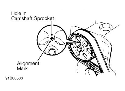

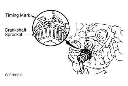

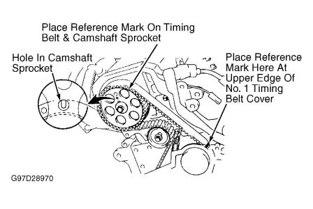

there r three different notches on the cam gear.which notch do I use to set time and at what angle at top dead center? and also where crank shaft gear how many resoultions do i go around for top dead center? which way do the notches have to face?

1. check the pics 2. take a note on the cam has a small hole and should be up lining up with the marking on the head
https://images.2carpros.com/forum/automotive_pictures/99387_toyo_4.jpg
https://images.2carpros.com/forum/automotive_pictures/99387_toyota_timing_1.jpg
https://images.2carpros.com/forum/automotive_pictures/99387_toyota_2.jpg
