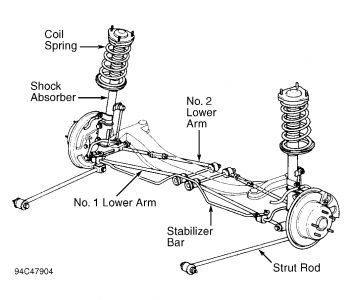

rear right has rattling noise and when hit bump it bangs told it was strut ? so how can tell and how to replace im no pro but know how to follow directions and mechanicly inclined

Compress and extend shock rod to check for abnormal resistance or noise. Push shock absorber piston rod in fully and release. Piston rod should return at a constant speed throughout its travel. If shock is defective, replace as an assembly.
https://images.2carpros.com/forum/automotive_pictures/99387_Graphic1_725.jpg
