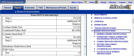

I need to know how many pounds of pressure do I need to adjust the engine block.

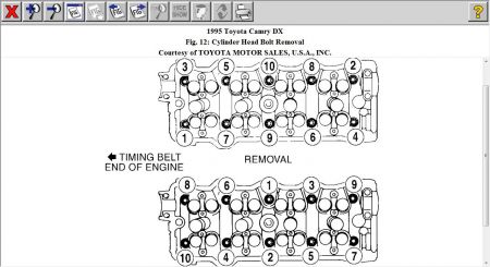

My father is repairing my Toyota Camry. The cilinder head, I think that's the name, need to be adjust becuase the car got a high temperature few weeks ago. I've stop the car and he is repairing it. He asked me to look for information about the correct pounds of pression to put the cilinder head back. Thanks for your reply. Ivelisse

No problema on the lingo-See below and good luck amigo
https://www.2carpros.com/forum/automotive_pictures/12900_head2_7.jpg
https://www.2carpros.com/forum/automotive_pictures/12900_head_7.jpg
