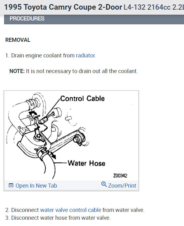

I have changed the thermostat, the blower is working, what suggestions do you have?
Thursday, September 25th, 2008 AT 12:21 AM
  • 75,992 POSTS

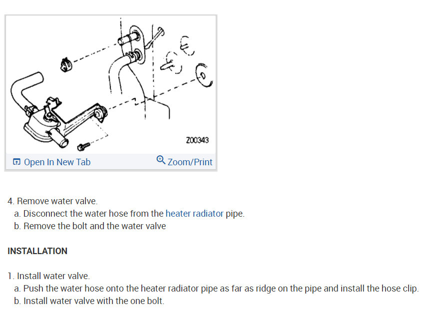

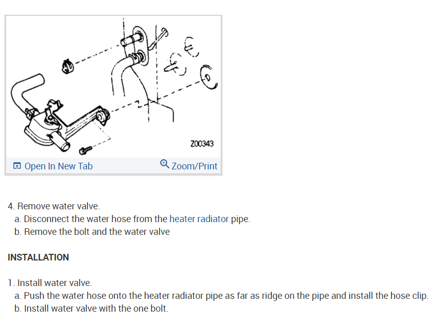

Check the heater hoses and heater core if its clogged-up also the heater control valve if its functioning properly check out this guide which tells how to fix it. The heater valve is in the diagrams below,.
