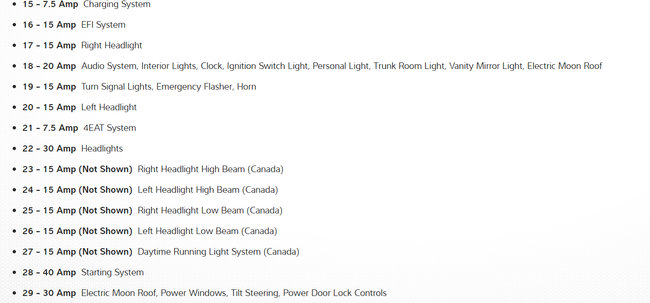

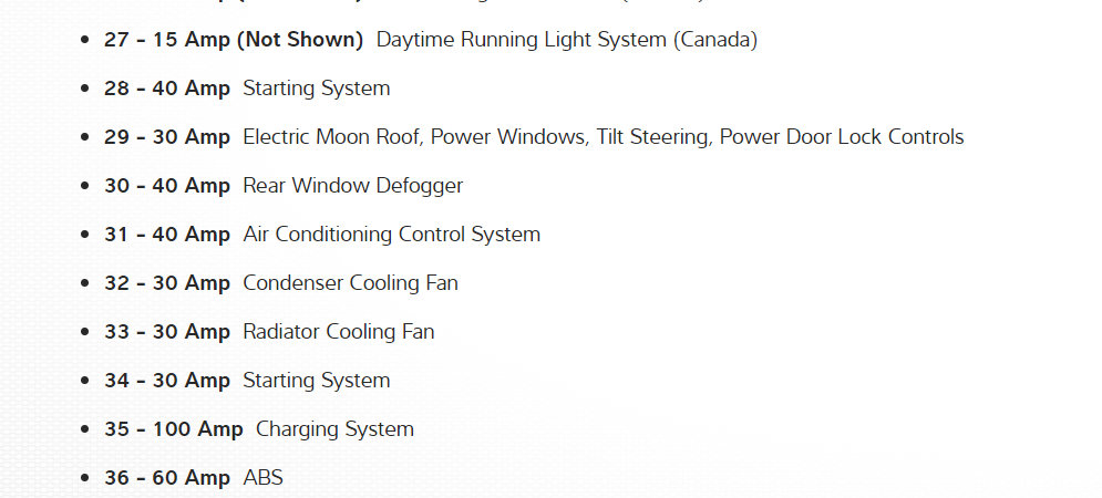

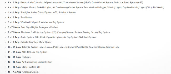

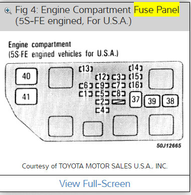

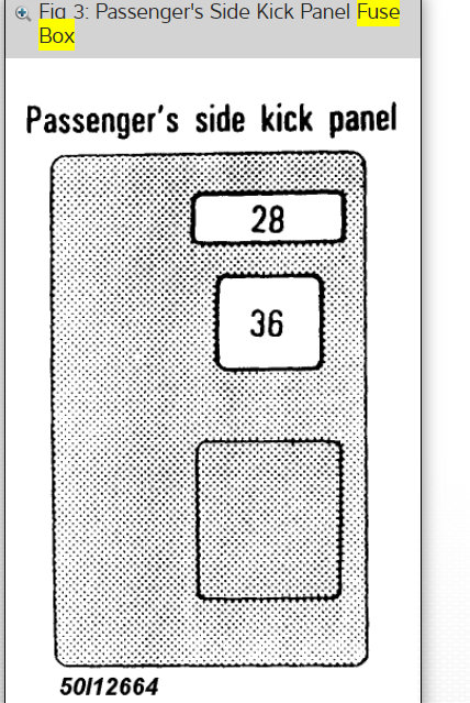

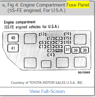

my car dash panel,light are off i changed all light bulbs and still out of light,i checked the fuses box inside and by engine side and i dont found any fuse bad, do you think is the dash board or the light adjust control ( dimmer ), i dont know beside of those fuses box the car have another one. Thanks for you help.
Uzziel
Nov 1, 2008 at 3:42 AM
  • 75,988 POSTS
the light adjust control ( dimmer ), this is the one that controls the dash lights thru a rheostat check it out.
This guide will help

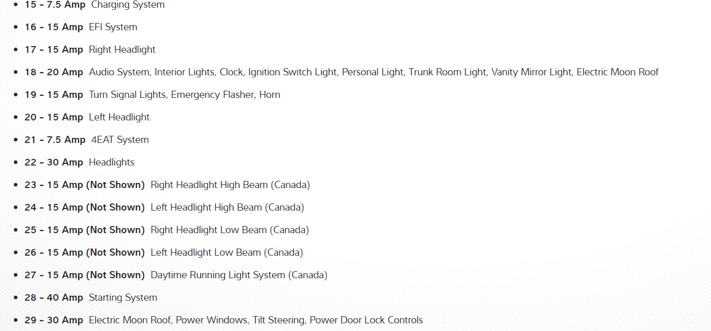

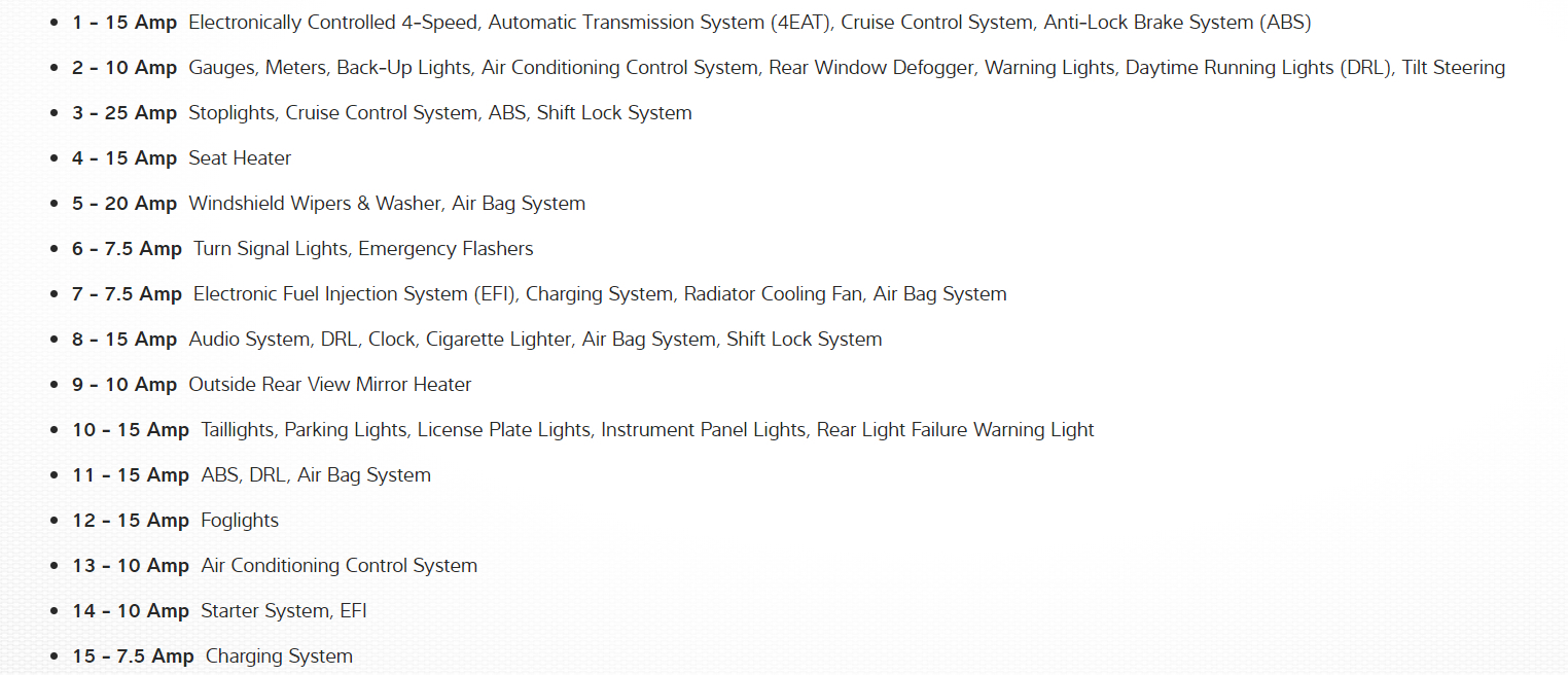

Check out the diagrams (Below). Please let us know what you find.
