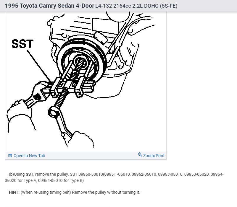

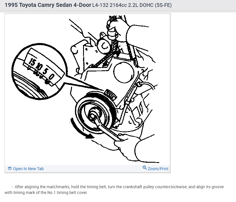

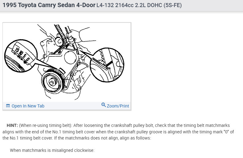

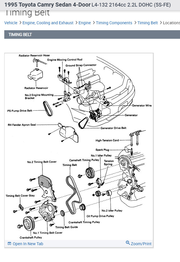

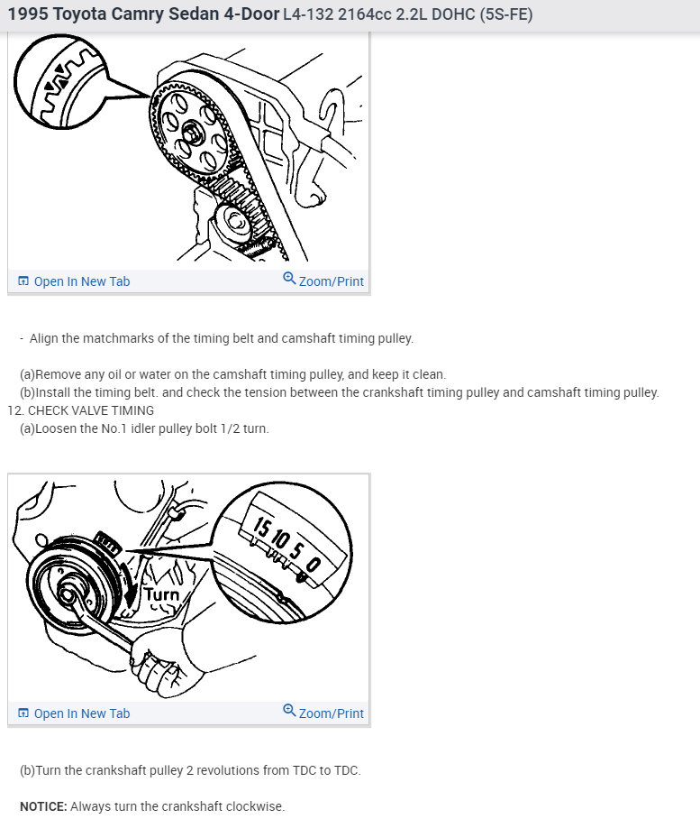

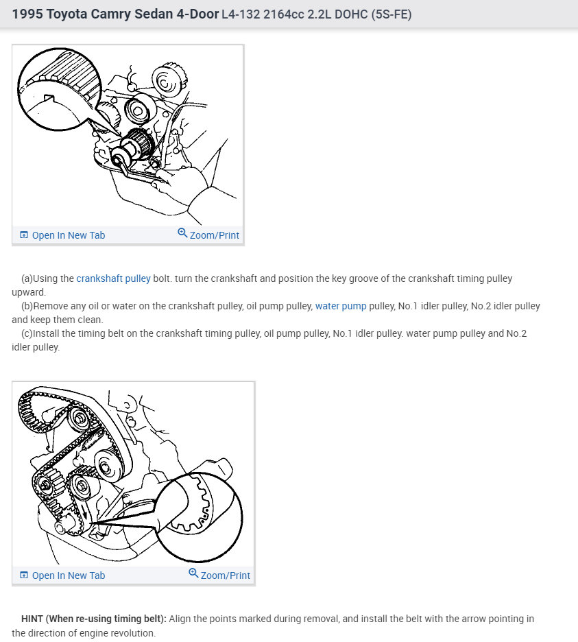

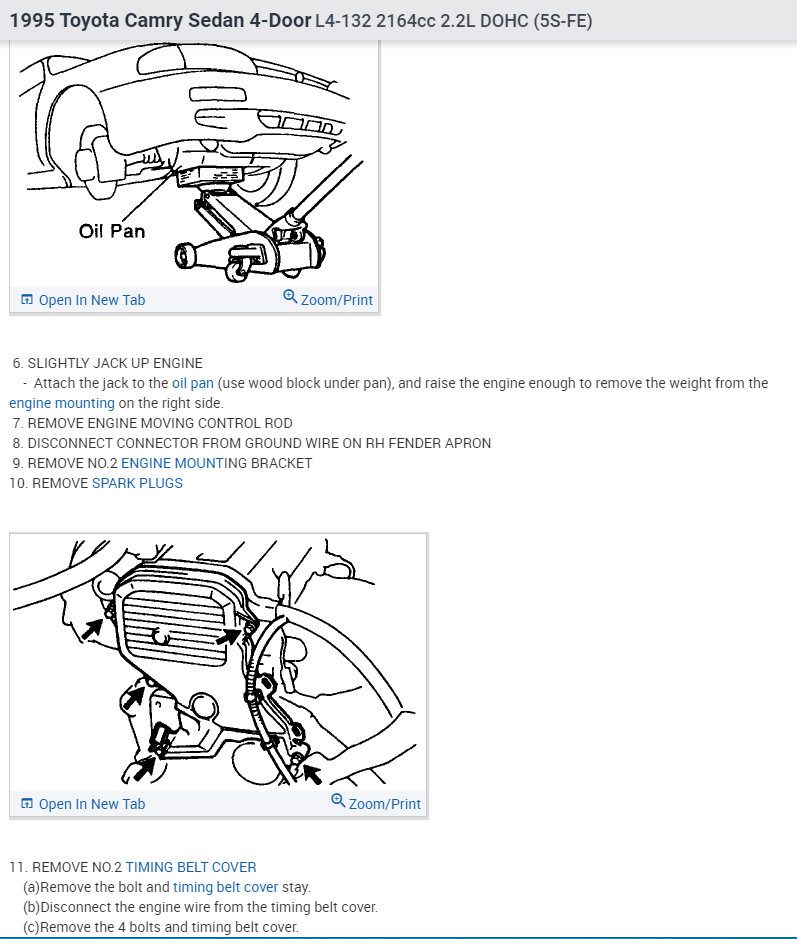

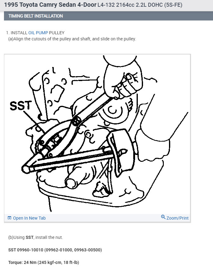

Poor acceleration can be caused by a clogged fuel filter. So, changing that is a good idea.
https://www.2carpros.com/articles/how-to-change-a-fuel-filter

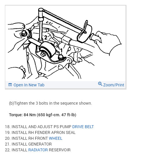

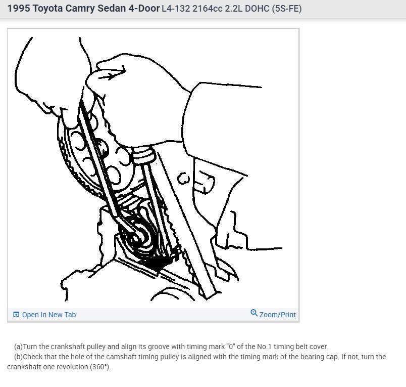

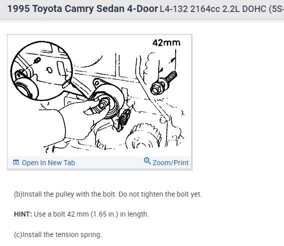

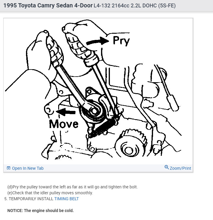

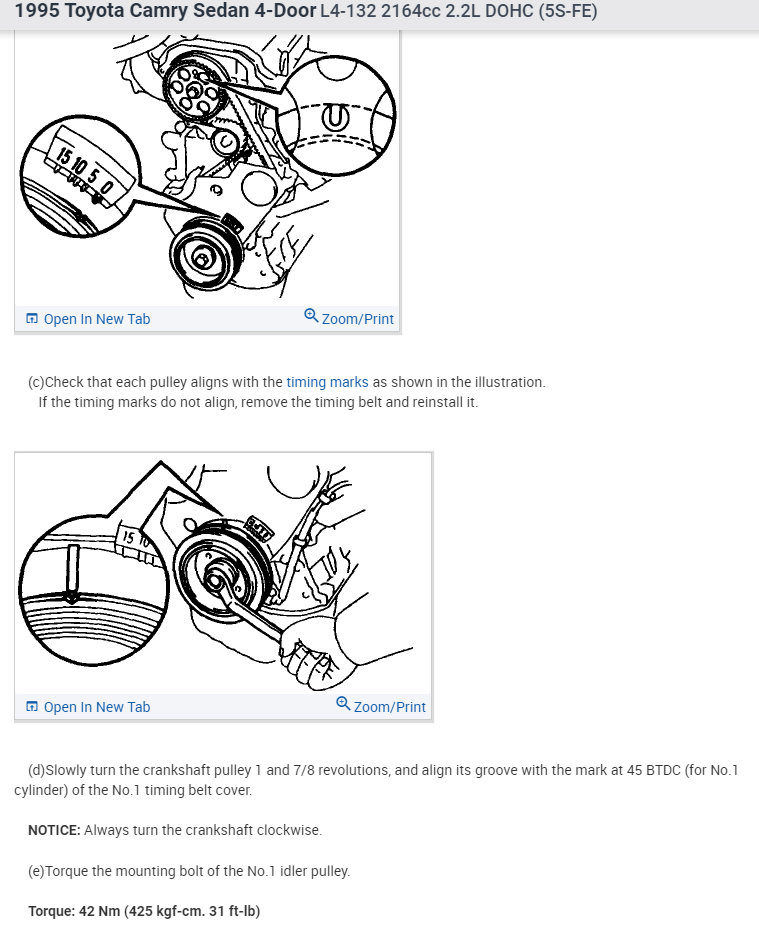

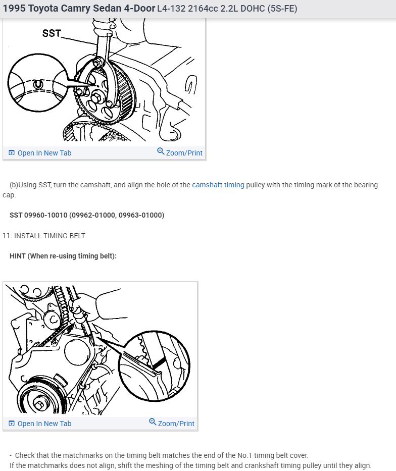

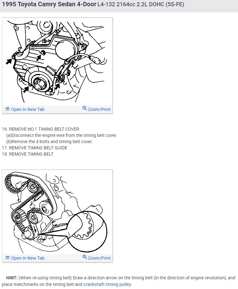

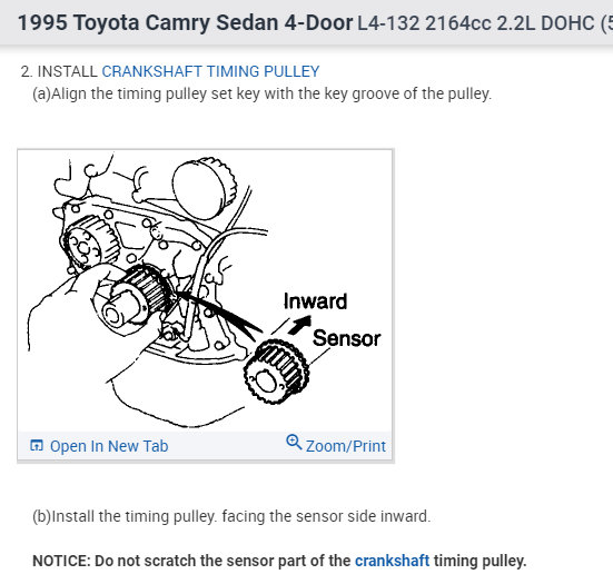

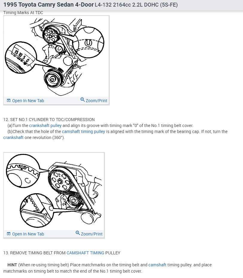

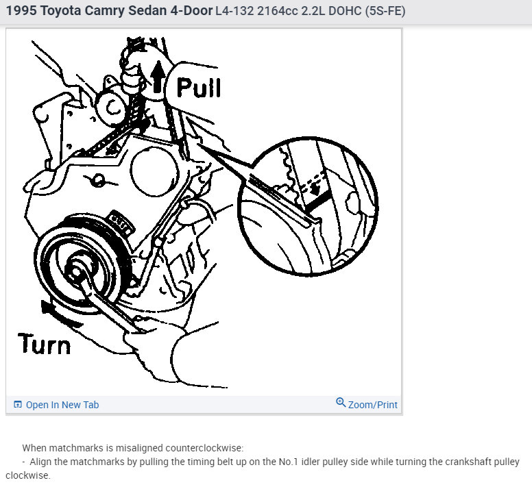

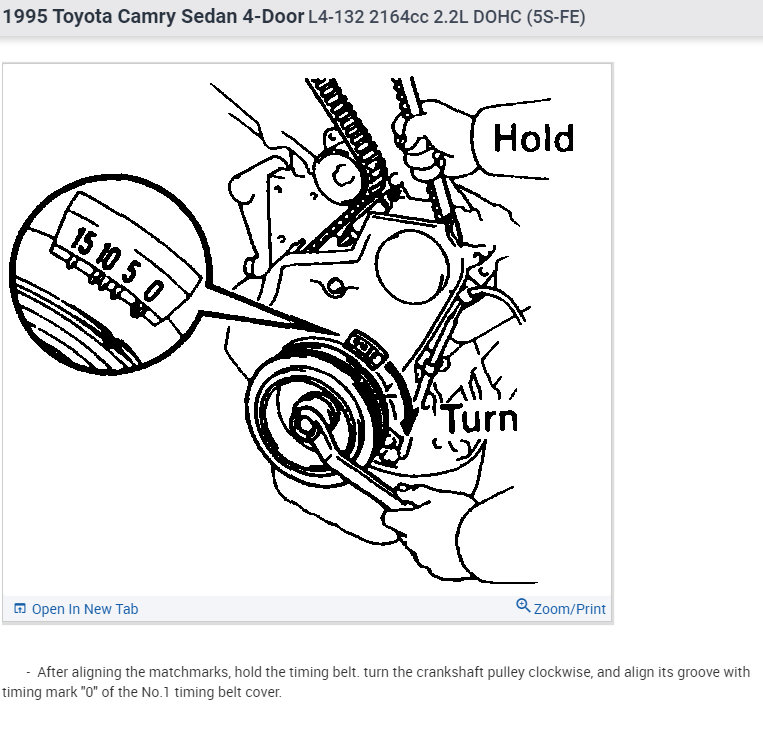

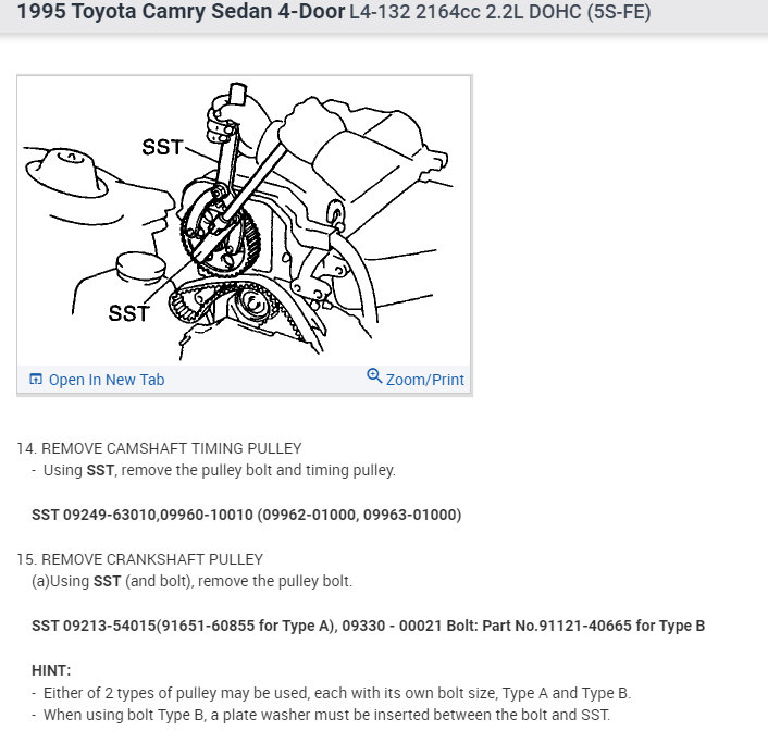

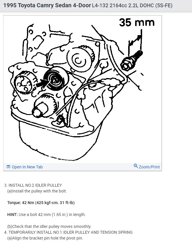

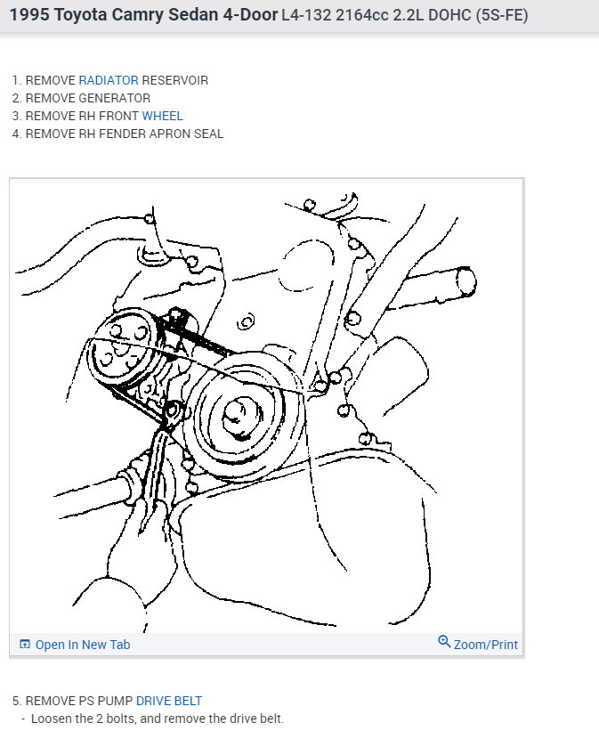

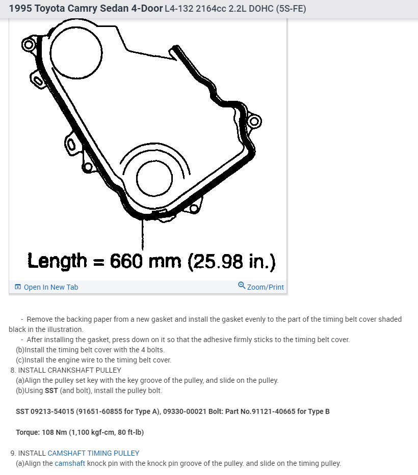

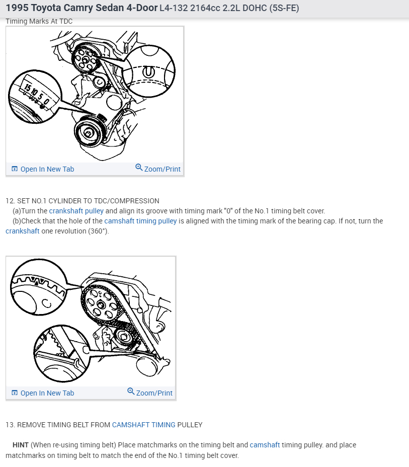

However, what you are describing sounds like the timing belt might have gotten worn and skipped a tooth. Which is making it difficult to accelerate. I have seen this happen before that a faulty timing belt can impact acceleration. And typically, it will do that before it breaks.
https://www.2carpros.com/articles/how-a-timing-belt-works
