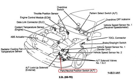

I need to know where the neutral safety switch is located?

Your vehicle's park/neutral position switch is located on the left front side of transaxle (pictured below)..
