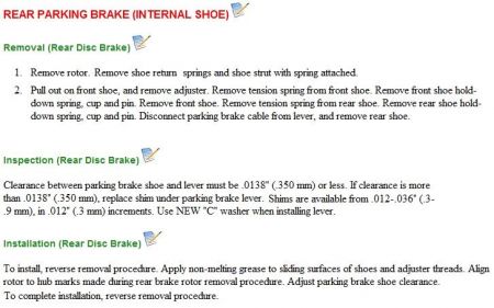

I have disk brakes, and have removed all old E-brake parts and shoes from the rear wheels (no problem removing), but do I have to pull the bearings to replace the E-brake shoes ?
