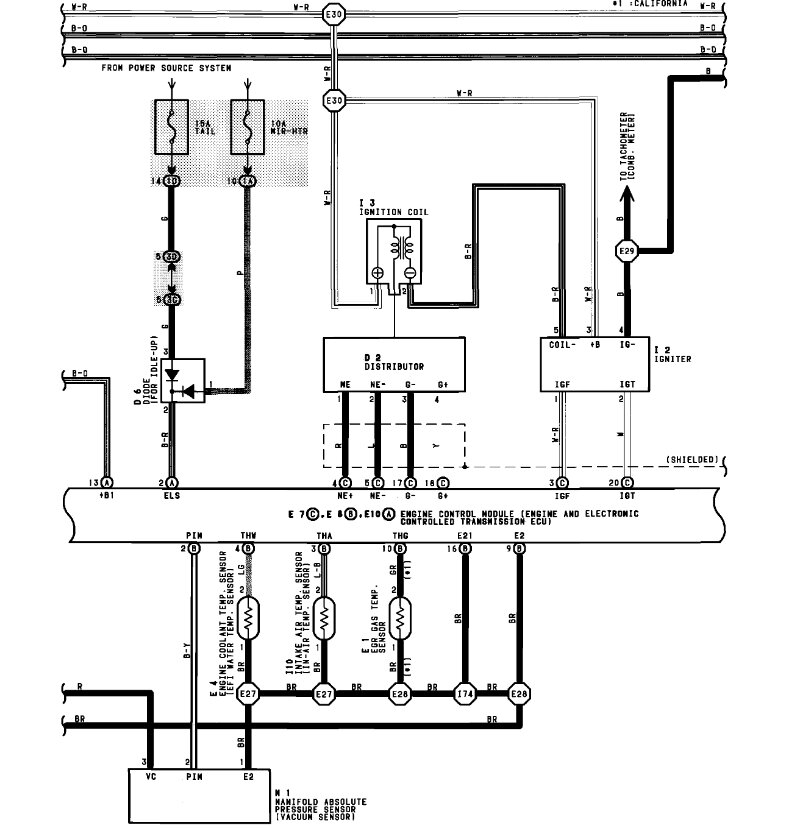

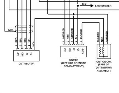

I'm not getting power from ignition switch to the ignition coil. The coil ohmes out good.
Instead of replacing the switch I'd like to run an auxilliary circuit to energize the coil. Trouble is, the Haynes manual shows colors at the plug, not present in the actual car. I'm guessing Toyota is using this as a junction as I never saw a coil with more than two primary side connections.
The colors at this plug are (in order from front to back) Yel, Blk, Blu, and Red.
Can you tell me which two I can use to fire the coil up (either colors or plug position)?

My question was straight forward - What colors AT THE PLUG energizes the primary of the ignition coil on my Toyota Camry? BMRFIXIT took me everywhere but that plug or those wires.
If the computer doesn't allow me to fire up this coil using an auxiliary circuit, then just say so. I know energizing the coil this way would allow the car to be started in gear, etc. but I didn't ask that.

Federal or California emission ???
From the switch BLK/ORG and continue
with the color WHT/RED to the igniter and then to the coil
check for power at the BLK/ORG wire at the ignition switch and dont have it with key on
run a test fused wire and check if that solve the issue for you

Is it Federal or California emission ??? computer control the ground you have no power ?(so you said ) and was looking to bypass the switch, was my understanding if the problem an ignition switch, the color wire i gave should supply power to the coil and start the engine and no need for any thing else OK lets try again coil wire are part of the dist.

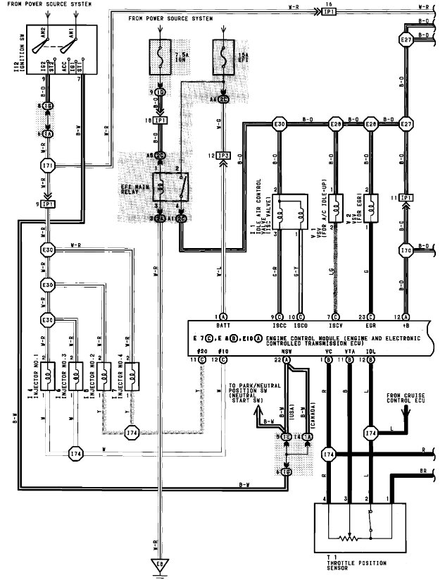

  • 54,897 POSTS
Here is the complete engine wiring diagrams for the engine and ignition system for a 1993 toyota camry and a guide to help with testing the wiring:
Check out the images (below). Let us know if you need anything else.
