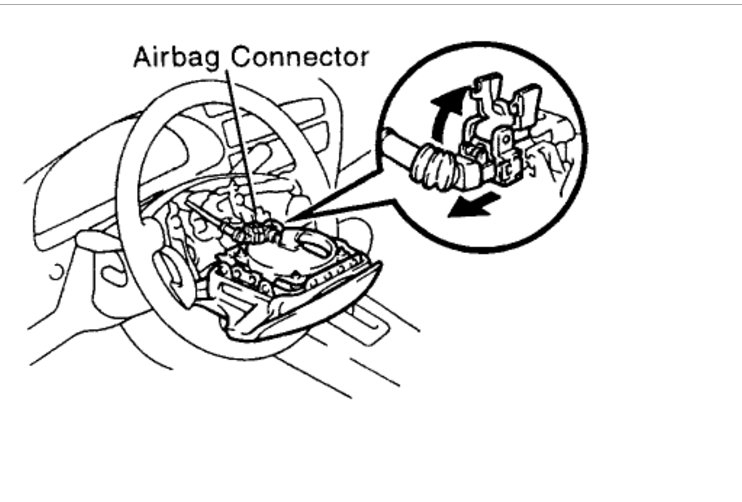

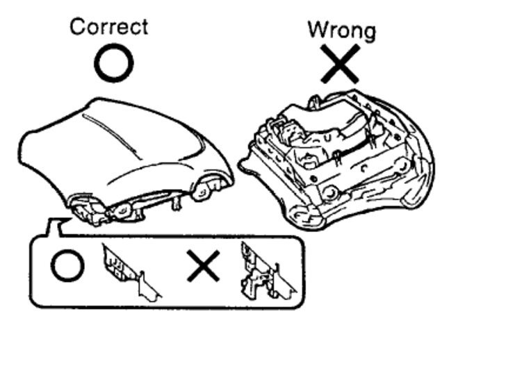

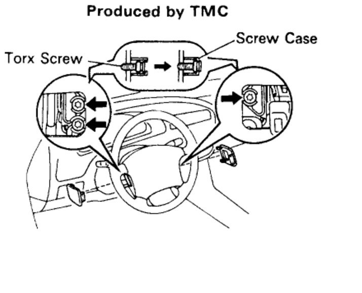

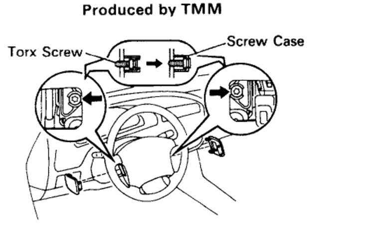

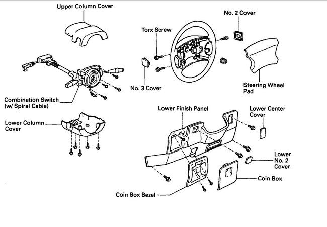

How do you replace the airbag?
This site rocks
Feb 4, 2010 at 6:30 AM
  • 55,273 POSTS
Here is a guide that will show you what you are in for when removing the airbag. You must start by disconnecting the battery.
https://www.2carpros.com/articles/air-bag-removal-steering-wheel
Here are some diagrams that shows what it will be like on your car (below)
