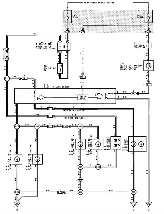

Press Brake Pedal after starting engine, Get Reverse Gear Light Activated while touching brake pedal(every time without fail),
Rear Tail Light Warning comes on and stays on after starting engine and stepping on Brake Pedal as well.

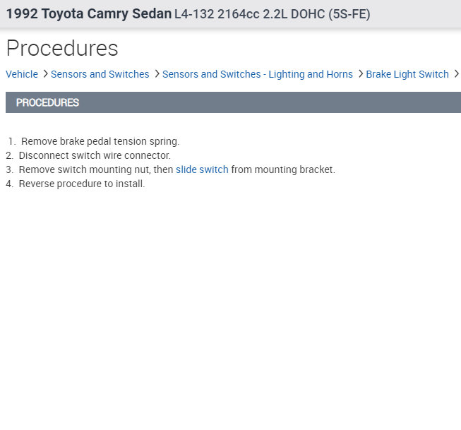

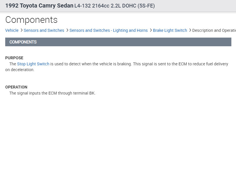

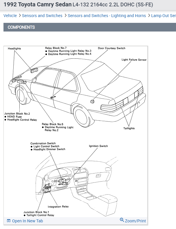

This could be an issue with the light failure sensor. It is likely malfunctioned and triggering the light out warning even though the light is functional.
The light out warning works alongside the brake light switch so it could be both of those components being faulty.
