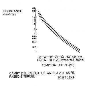

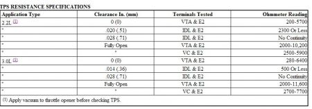

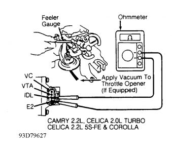

Thanks for the reply. Valve and ignition timing are spot on, and I've got good compression. I thoroughly cleaned the AFM and sensor, (in addition to throttle body, etc), with no change in performance. I am not familiar with how to test the AFM sensor. I am also unfamiliar with how to test the TPS, other than to adjust it. I suspect that one of these sensors is the problem, thought I'm reluctant to simply replace them... I've replaced so much and I'm running out of money. Any help you can offer is very much appreciated.

these can be tested with a multi meter, i feel that your problem may lie here, if the TPI has been moved that will cause all manner of problems, do you have a work shop manual? as it may give you all the values for checking these sensors.

Hi there, a few tests to go on with...
https://images.2carpros.com/forum/automotive_pictures/61395_pic_1_5.jpg
https://images.2carpros.com/forum/automotive_pictures/61395_snap_1_8.jpg
https://images.2carpros.com/forum/automotive_pictures/61395_pic_2_1.jpg
https://images.2carpros.com/forum/automotive_pictures/61395_snap2_1.jpg
