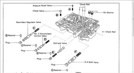

1992 Toyota Camry 6 cyl Front Wheel Drive 265000 miles
Hi there, have a problem where when I took the bottom cover off the valve body on auto trans A540-1a to fit new kick down cable I discovered 2 plastic balls had fallen out on dismantling. I have no Idea where they go in the valve body. any help on this would be much appreciated. Many thanks.

Sounds like check balls you need to find where it goes otherwise the tranny is not gonna function correctly see below
https://images.2carpros.com/forum/automotive_pictures/12900_check_balls_1.jpg
