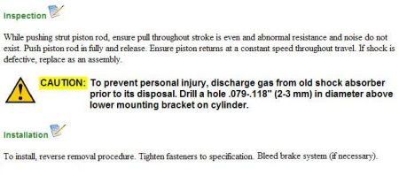

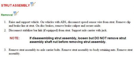

Replacing rear struts, How do I do this is it difficult?

Thursday, January 21st, 2010 AT 6:04 PM
