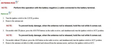

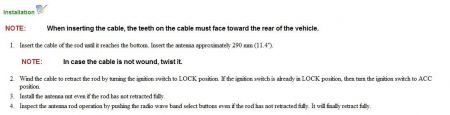

1992 Toyota Camry ANTENNA
GONZALEZ0427
MEMBER
1992 TOYOTA CAMRY
4 CYL
FWD
AUTOMATIC
120 MILES
Installation instructions for 1992 Toyota Camry 4 cylinder Automatic Antenna
Monday, March 8th, 2010 AT 3:53 PM
