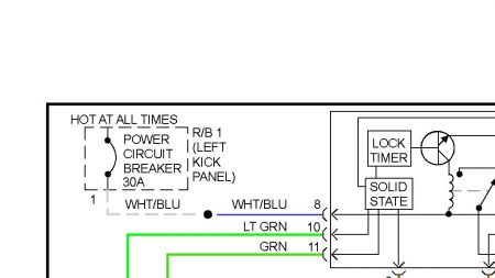

I cannot figure out whats wrong w/ all of my windows and door locks, none of them work. Can you please help me figure out what to do?
Apr 7, 2008 at 3:20 AM
Experienced Mechanic
75,988 POSTS

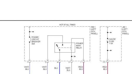

Sounds like the power circuit breaker it powers both Power window circuit check the power main relay/circuit breaker/fuse-
Door locks
