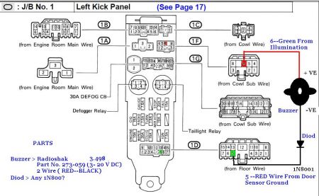

I want to connect buzzer ,so when my car's headlight is on & when i open door i will hear BEEP
i want to connect buzzer's +ve with headlight +ve
and Buzzer's -ve to Door's sensor
Please help to find cable & cable color so i can install buzzer to save my battery
Or if u have any idea PL Let me know
Thanks in advance
From brother hood
Feb 10, 2009 at 12:48 AM
BIRBALGURU
i found the solution
https://images.2carpros.com/forum/automotive_pictures/7220_91CamryHeadlightBuzzer_2.jpg
