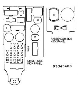

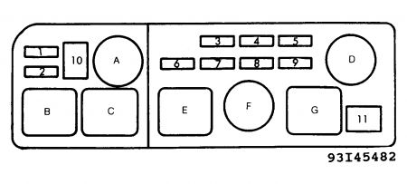

I took my battery in after connecting my negative to my positive and positive to neg when I was jump starting my car cause I was half asleep and rushing I know my efi fuse was blown and changed it I got a new battery now but my monitors where my gauges in front of the steering wheel now don't pop on like the lights for change oil or check engine or brake none of those come on my car wont even turn over I know my starter is fine a new one was put in not long ago it has to be electrical could I have blown my computer or should I run through and change all my fuses? I know it's not my starter though!!!

Vehicle has 3 fuse panels. Instrument panel fuse box is located on dashboard, left of steering column. Passenger-side fuse box is located behind passenger-side kick panel. Main fuse and relay block is in engine compartment, near battery. Use a test light and all check fuses and links. https://www.2carpros.com/articles/how-to-use-a-test-light-circuit-tester
