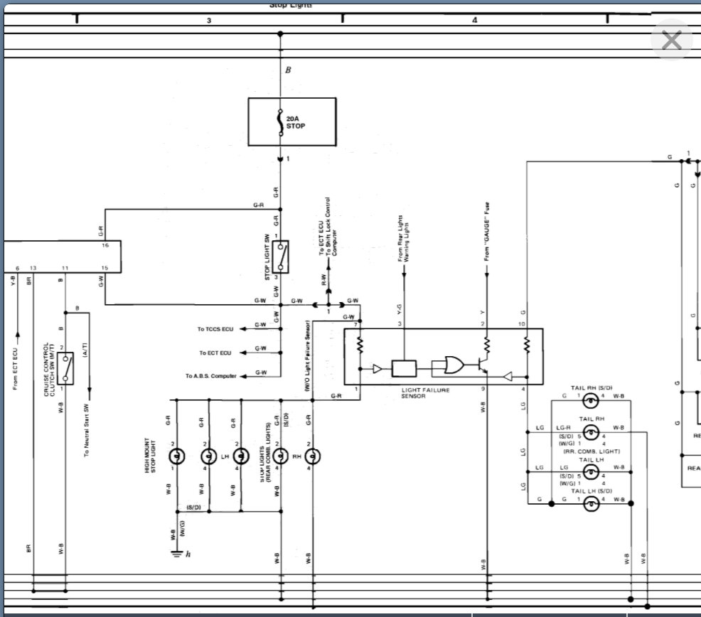

My warning light keeps coming on .to warn me theres a light out .But theres no lights out . I notice it only comes on when i step on brake pedel. restart the motor it goes out ,comes back on hit brake pedel. Some times it go off for a few weeks then come back on ...

More than likely you have an issue with the light failure sensor.
I am attaching the wiring diagram below that will help with this, but we need to check the voltage on each of the wiring coming out of it.
Basically, on pin 3 you should have no voltage and if you do then more than likely the resistor inside the unit has failed and it needs to be replaced.
Here is a guide that will help with this:
Please run through this and let us know what questions you have and what you find.
Thanks

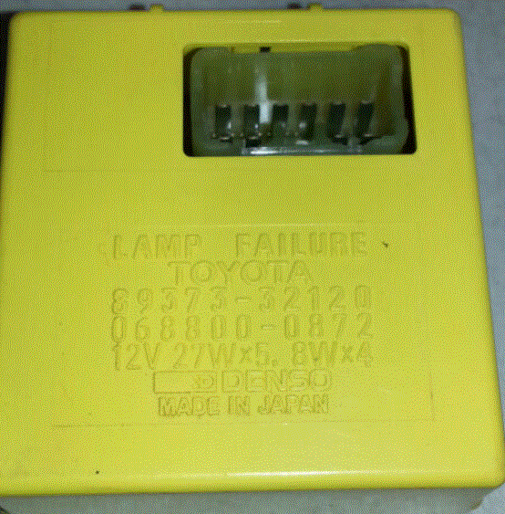

I just went through two manuals and neither shows the location. So, from memory, if you open the trunk, it should be behind the left side insulator. It will be a yellow box approx. 3"x3".
I attached a pic below of what you are looking for. Let me know if this helps.
See pic below.
