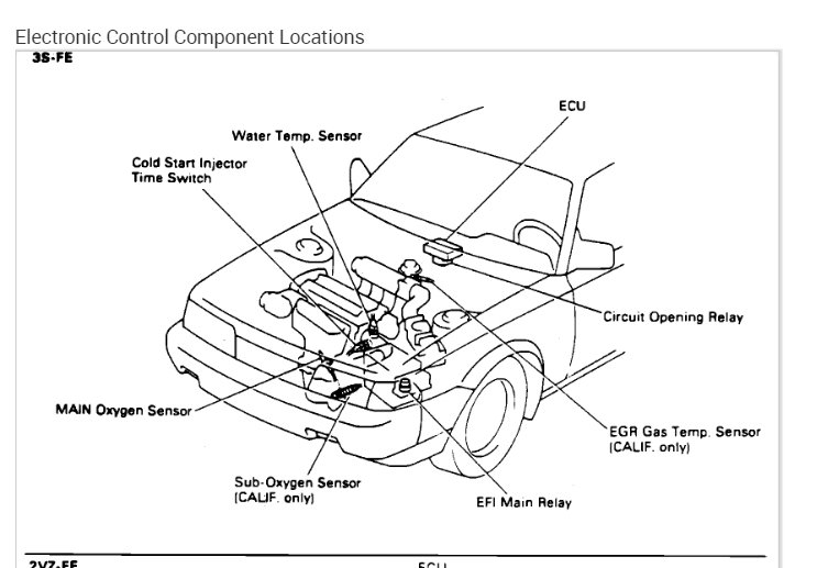

I have a 89 toyota camry that isnt firing change complete distributor from running car and nothing changed ignitor and nothing what else could it be?
Oct 30, 2009 at 4:12 PM
  • 75,992 POSTS

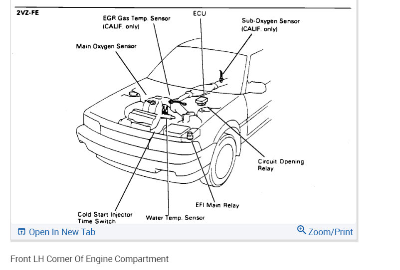

This happens when the main engine relay goes out. This guide can help you test it and the location of the relay is in the diagrams below.
