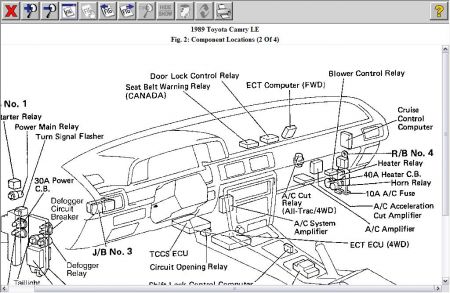

Where is the blower motor relay at?
Dec 21, 2007 at 7:17 AM
  • 75,992 POSTS
Its on the fuse/relay panel No.3 under right side of dash see below Merry Christmas
