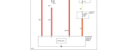

i pulled the wires out of the back of my 89 toyota camry alternator (generator connector) there are 3 wires black with yellow strip--white-- and yellow how and can i put them back in. what order do they go.

White wire-goes to the alternator battery terminal Yellow-goes to the charge indicator/Charge fuse and Black and Yellow to engine fuse
https://images.2carpros.com/forum/automotive_pictures/12900_alty_83.jpg

Could you tell me where on the back of the alternater where the plug goes(generator conecter) what order do the wires plug into the 3 terminals.(What wire goes where)
