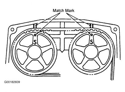

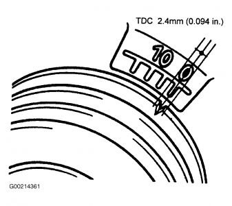

i recently removed the engine and transmission so I could repair and oil leak on the top seal where the timing belt is located and all so replaced clutch plate and disc. After I put it all back together, I cranked the car up and then put the shift in reverse and it stuck in reverse and the 0 on the crank/cam shaft which I think the belt mite need to be aligned again, is not aligned where it should be. What can I do

Check that the two selector cables are installed correctly and the shifter quadrant in the cabin is ok, as for the valve timing check as per pic.

https://www.2carpros.com/forum/automotive_pictures/61395_Graphic_152.jpg
https://www.2carpros.com/forum/automotive_pictures/61395_Graphic1_15.jpg
Wednesday, June 23rd, 2010 AT 1:27 AM

Im confused on how to adjust timing and or do I have to remove transmission again

You will not have to remove the transmission, but is the valve timing correct as per the pic's I posted.
