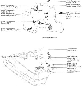

1987 Toyota Camry CAn't find it
1987 TOYOTA CAMRY
167,000 MILES • 4 CYL • 2WD • AUTOMATIC
LAWRENCEL BROWN
Where is the back up light switch located on this car?

The backup light switch is incorporated into the Neutral Start Switch, which is attached to the transaxle. http://www.2carpros.com/kpages/auto_repair_manuals_alldata.htm
