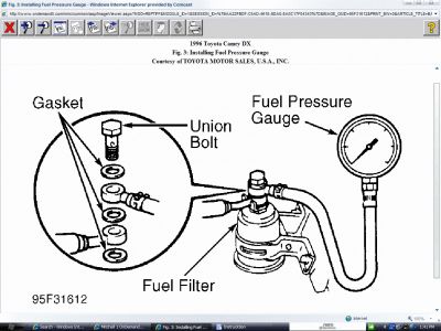

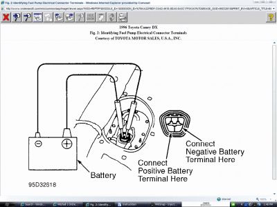

I would like to know where I can find the fuel pump on this model. I need to repair it and I dont know where it is.

Remove the rear seat, and the cover plate under it. Test it this way...
https://www.2carpros.com/forum/automotive_pictures/62217_Pump_1.jpg
https://www.2carpros.com/forum/automotive_pictures/62217_Pump2_1.jpg
Key on engine off pressure should be 38-44 PSI, running 33-38PSI If you apply battery voltage as show, no more that 10 secs at a time! Pump can overheat!
