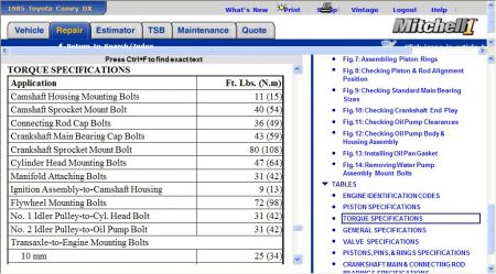

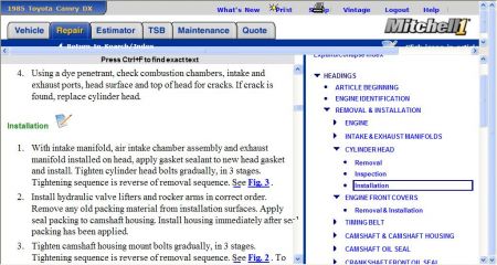

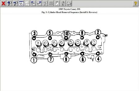

What torque do I tighten the head down and what sequence?
Friday, July 25th, 2008 AT 10:46 AM
MECHANIC
75,992 POSTS
See below-You select the torque lbs within the 3 stages
