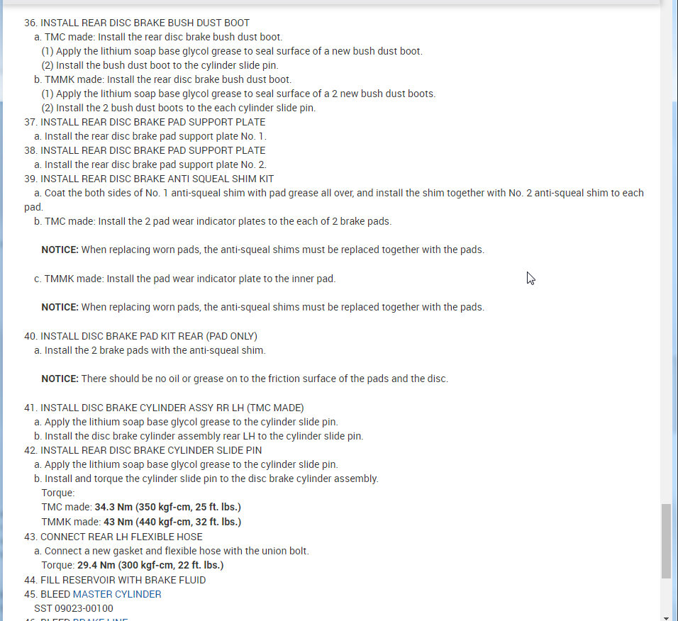

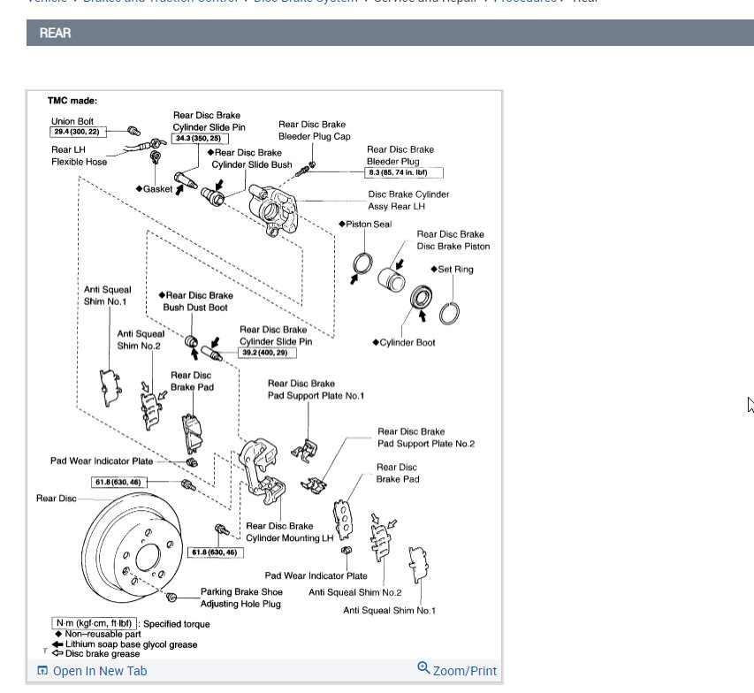

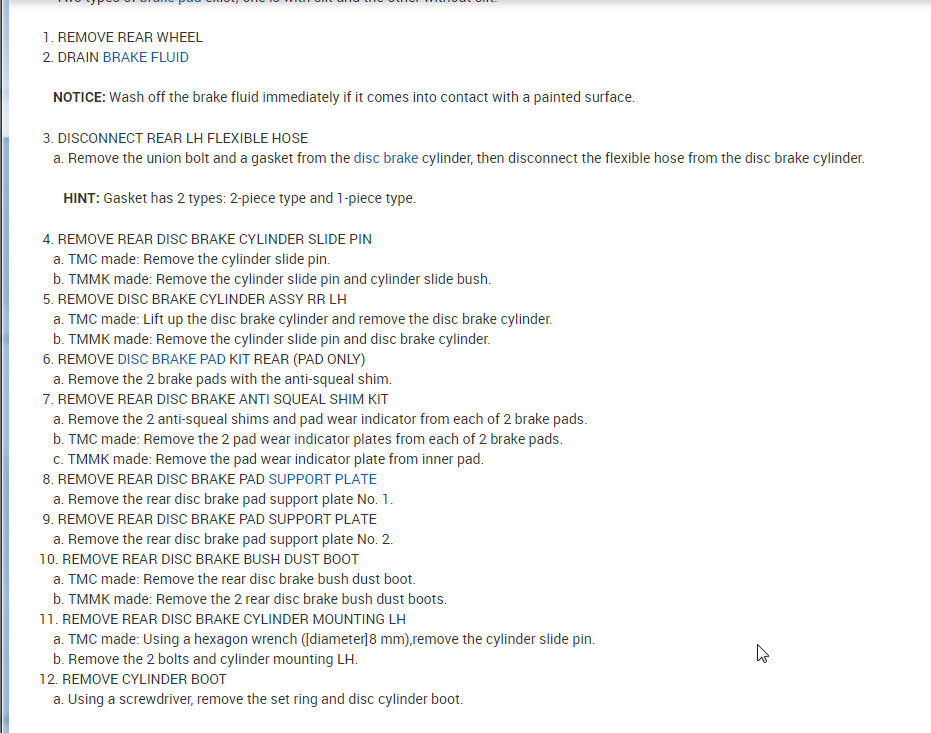

Hello, I'm trying to order a set of rear brake pads and disks but am asked by the seller to provide the size of the disks, options being 288, 271 280mm. I'm concerned that I wont be able to do the brake job can you help?
Apr 12, 2010 at 4:43 AM
Here is a guide that will help with this:
https://www.2carpros.com/articles/how-to-replace-rear-brake-pads-and-rotors
Also, the only way to know for sure which size rotor you have is to measure the current one or look the VIN up on a dealers parts system and have them give the specific part number.
However, here is the process on how to replace these from the manual. Let's run through this material and let me know if you have questions. Thanks

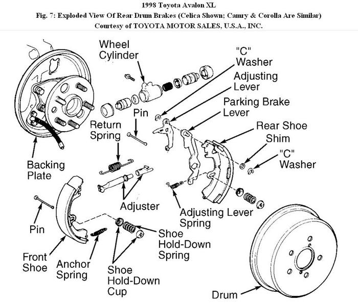

How to remove the rear brake drums on a Toyota Avensis TD estate 1998
Mar 3, 2021 at 6:21 PM (Merged)
KHLOW2008
  • 41,814 POSTS
Here is an exploded view of rear drake components. What is the problem that you are facing?
MARK_MALARKIE
I'm trying to do this drum removal on a '98 Avensis...drum won't come off, even when screwing in 2 extracting bolts...Haynes manual says to use a wire hook to back off trailing shoe but can't figure this out...any advice appreciated...
Thanks
