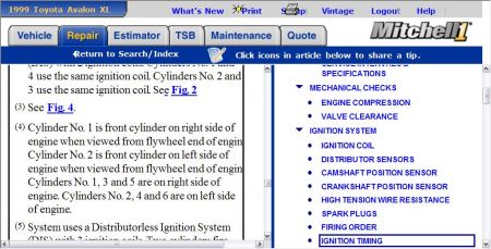

I am trying to tune my 99 Toyota Avalon 6 cyl. and I only see 3 ignition wires that are located in the front of the engine. Is that all there is? Mileage is 174,000miles

What you got is a DIS set up. 3-wires/3 coils 1 will fire to 2 plugs. To get at the plugs see below Item no.4 Type of sparkplugs: NGK BKR6EKP11 or Denso PK20TR11 Good Luck, Hope this helps
