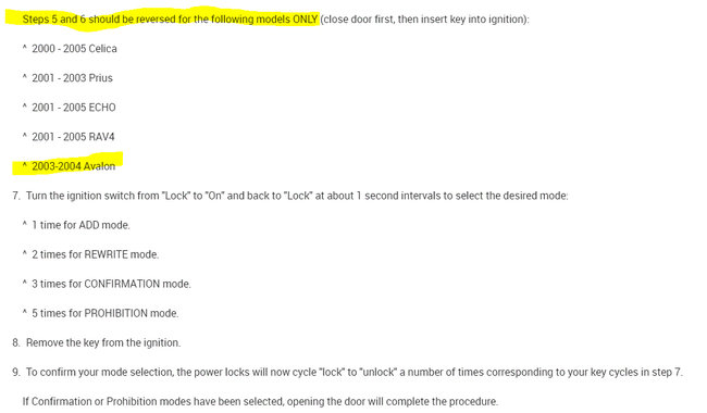

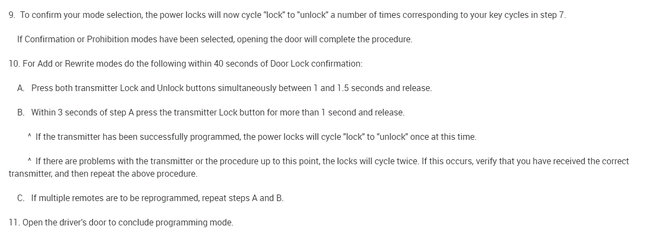

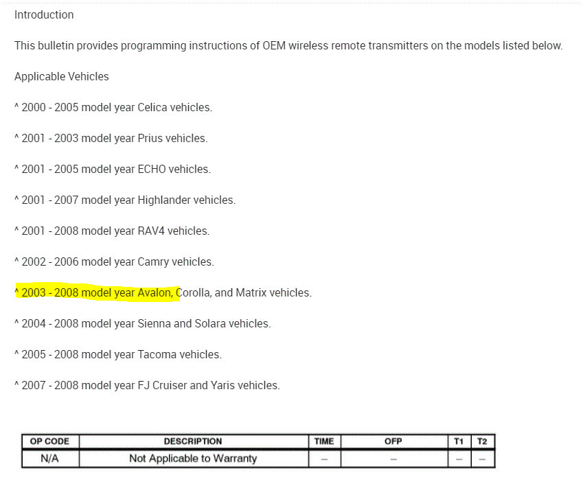

Hello, I purchased this car about 2 months ago. The problem is the original remote key fob which i only have one, worked okay for about a month then it started working sometimes then not at all. i checked the battery, it read 3.6v okay, next i bought a new remote key fob online with matching numbers on the old one, when i put the car in program mode and followed program instructions the door locks cycle (lock/unlock 2 times) it did not pair. so, i changed the door control receiver module which i got the same results not pairing what could the problem?

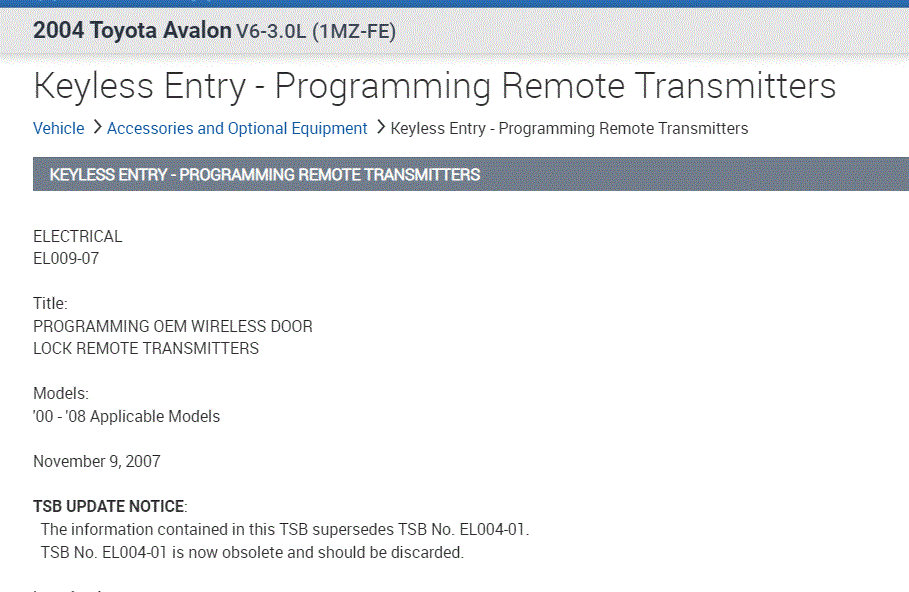

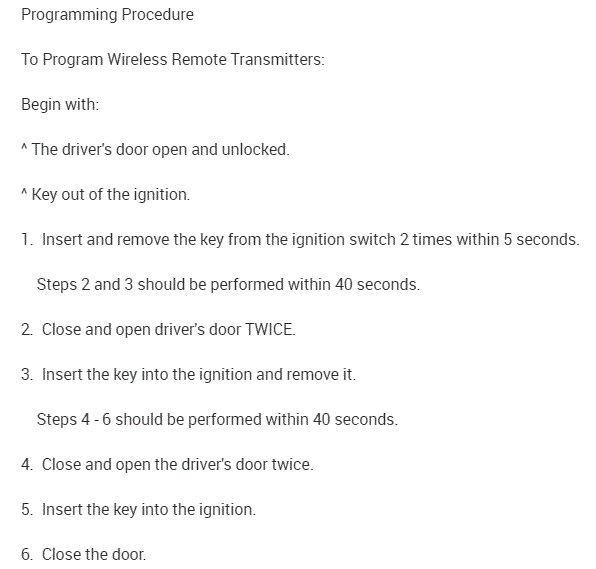

There was a technical service bulletin that indicates two of the steps need to be reversed on the Avalon.
I've attached the most updated TSB that I could find. Take a look through it and let me know if it helps.
Dec 28, 2021 at 9:54 AM

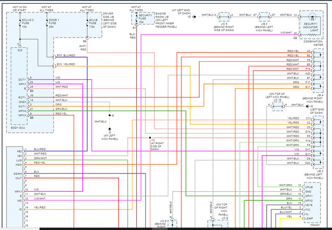

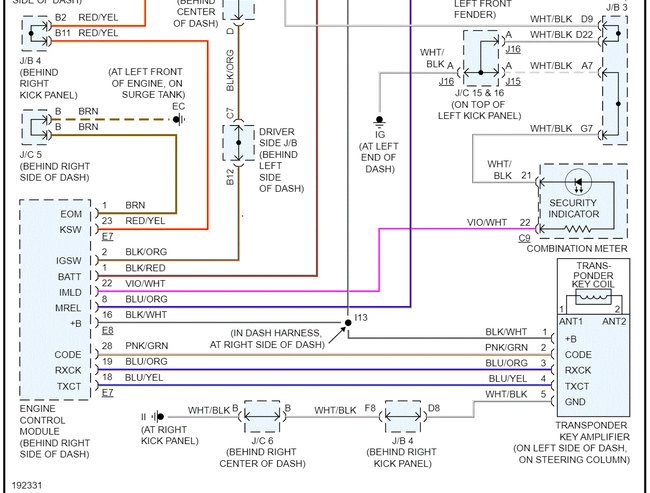

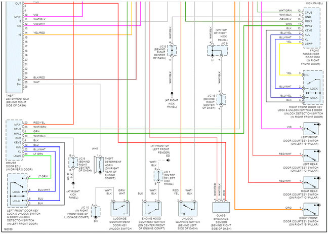

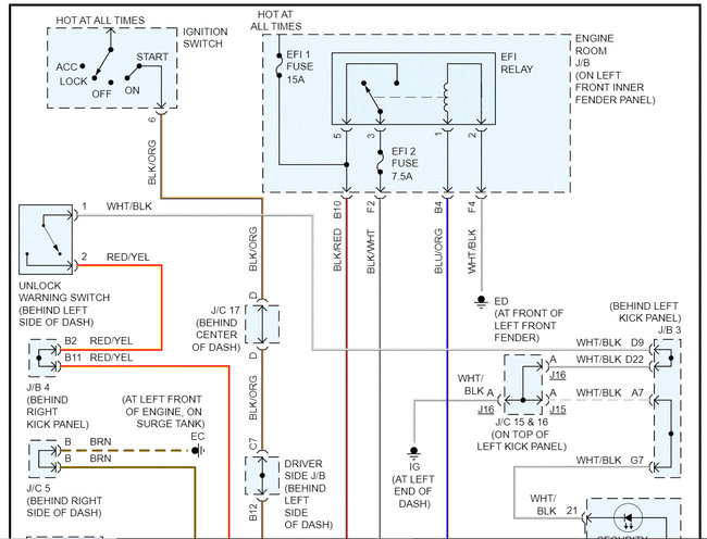

hello Joe, we have returned the new key fobs and decided to install a Car Security System Alarm with Keyless Entry and bypass the Toyota Keyless Entry system hoping this will solve the problem. Do you have a car alarm-wiring-diagram for the Avalon?
Dec 29, 2021 at 12:34 PM
  • 110,240 POSTS
Yep, I have them. Please sit down before reviewing the schematics. LOL
The first 2 pics are for the anti-theft immobilizer and pics 3 and 4 are the forced entry schematics.
Let me know what I can do to help.
Dec 29, 2021 at 2:15 PM
