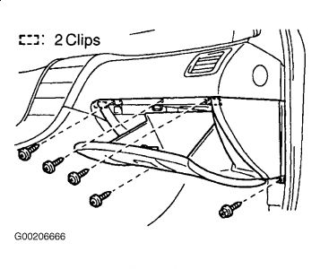

Trying to replace cabin filter. Can't remove glove box - took out screws. box won't drop down. problem seems to be at the light button and the trunk remote control buton. didn't want to force it.
Jul 17, 2009 at 1:11 PM
BLUELIGHTNIN6
  • 16,542 POSTS
Hello and thanks for the donation! Try this..to remove the cabin air filter and glove box, first open the glove box and remove the 5 retaining screws. Now that you are past that part already, you will need to use a flat bladed screwdriver to remove the lower panel.
https://images.2carpros.com/forum/automotive_pictures/261618_Graphic_81.jpg

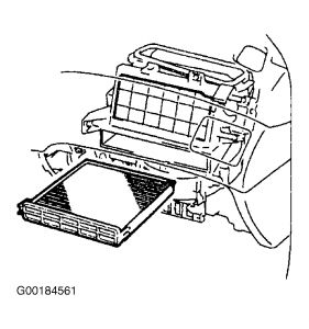

This will gain access to the electrical connector that you need to disconnect. Now you can remove the blove box and filter cover from the blower unit. Pull out the filter and remove the air refiner filter from the frame.
https://images.2carpros.com/forum/automotive_pictures/261618_2_53.jpg
Installation is reverse of these procedures..

I've done the 5 screws. diagram mentions 2 clips. I don't see any. Where do I insert the flat bladed screw driver to remove the lower panel?
Jul 18, 2009 at 1:51 AM
BLUELIGHTNIN6
  • 16,542 POSTS
2 clips are at the very left and very right of the end screws at top. Find the edges of the panel and start popping out the clips that hold it in by pulling it outward with a flat bladed tool / screwdriver
Jul 18, 2009 at 3:11 AM
MYTOY
I got it. You fellows are great, Thanks

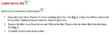

  • 75,992 POSTS
CABIN AIR FILTER
Removal & Installation (2000-2004)
Open glove box door. Remove 5 screws retaining glove box. See Fig. 1.Using screwdriver, remove the lower panel. Unplug electrical connector. Remove glove box.
Fig. 1: Removing Glove Box
Courtesy of TOYOTA MOTOR SALES, U.S.A., INC.
Remove the filter cover from blower unit. Pull out the filter. Remove the air refiner filter from the frame. See Fig. 2.
To install, reverse removal procedure.
Fig. 2: Removing Air Refiner Filter

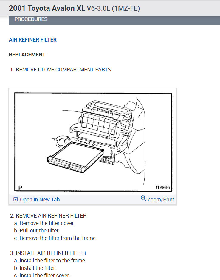

DOCFIXIT
  • 18,828 POSTS
Remove glove box 5 screws and a connector. Then you will remove filter cover . Remove filter reverse procedure to install. Here is a video of the job being done on a similar car with diagrams below to show you how on your car.
