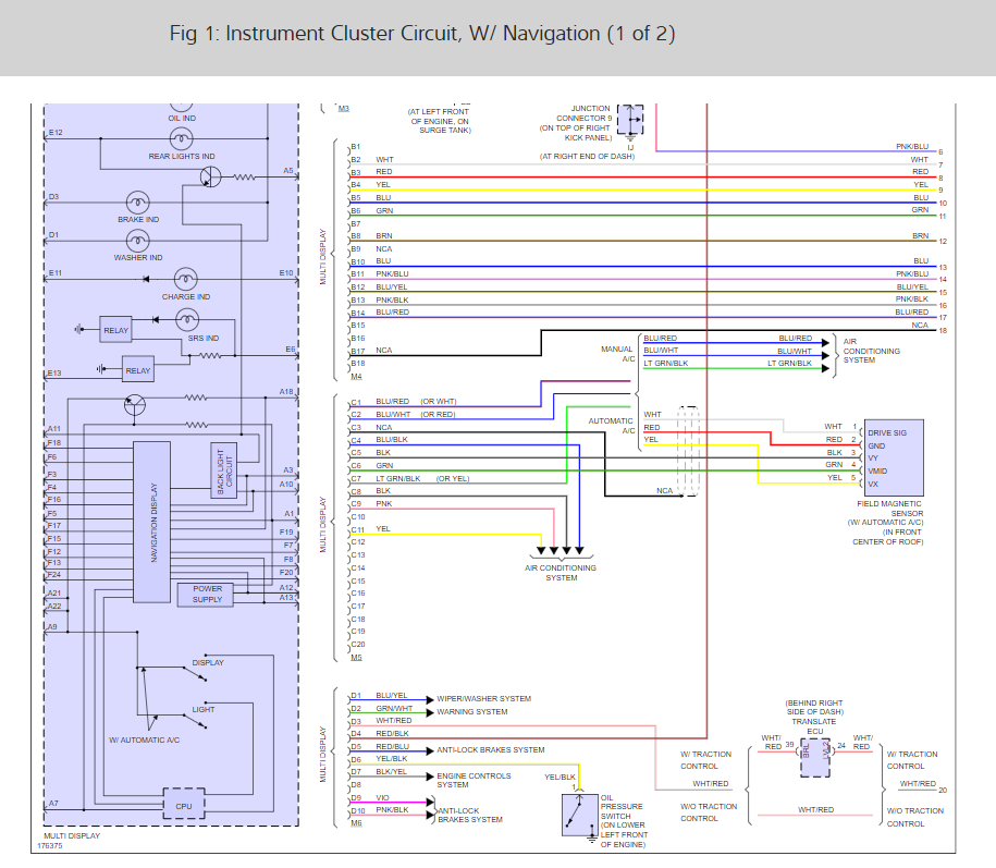

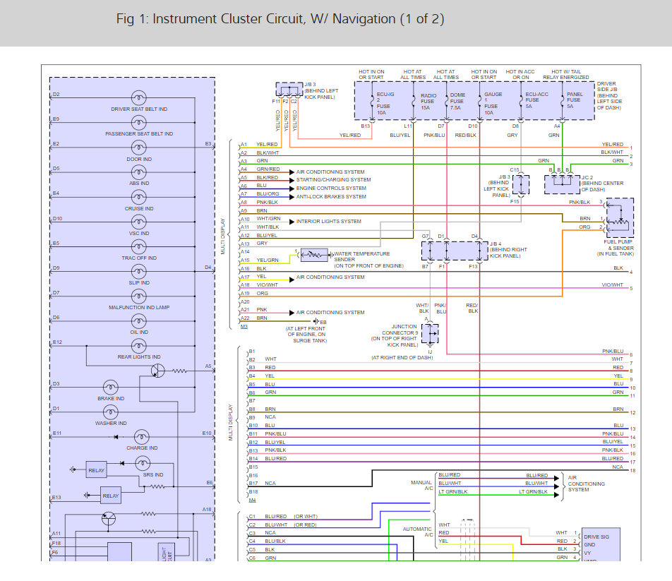

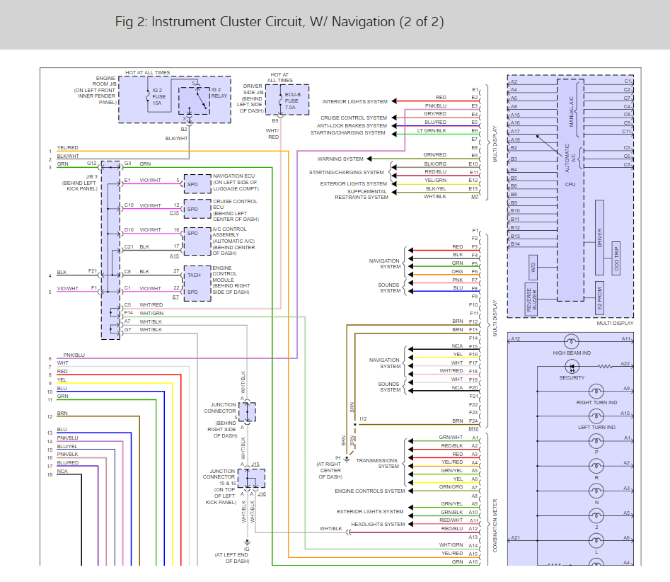

I had to Jump Start my car and since then my car Guages will not operatre. ( Engine coolant temp. gauge, Tachometer, Speedometer, Fuel Gauge and the Multi Information Display.)

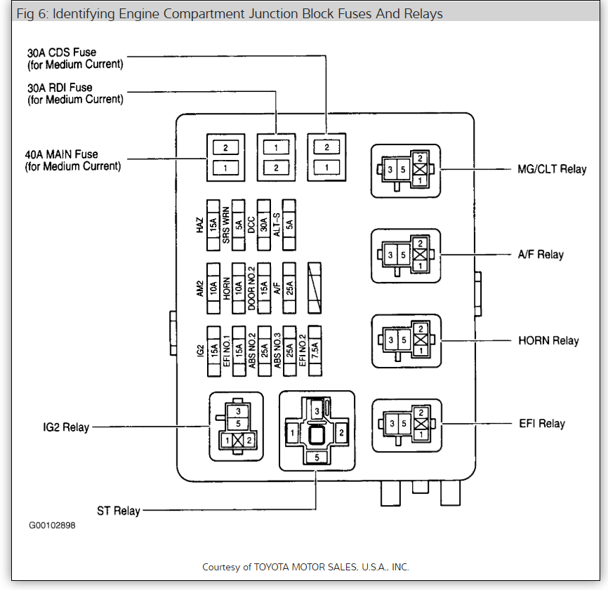

I tested all Fuses in the car and in the Relay & Fuse box near the Engaine. All the Fuses are good. (I don't know how to check the Relays.)
Please help me,
Ron
Jul 14, 2008 at 8:01 PM
  • 54,840 POSTS

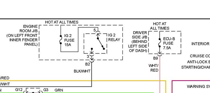

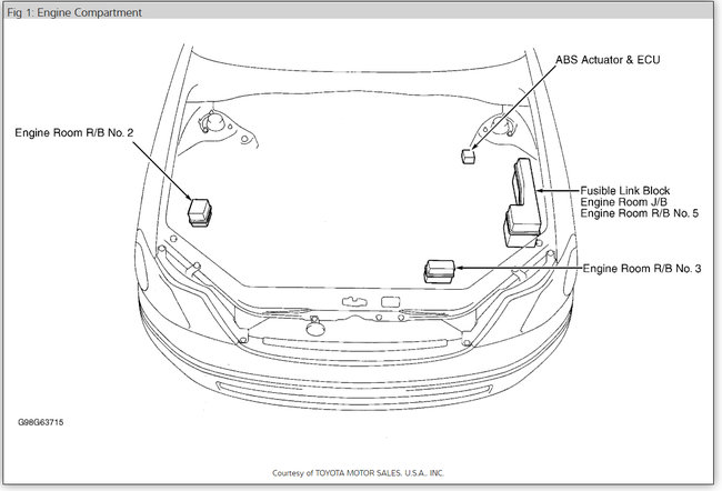

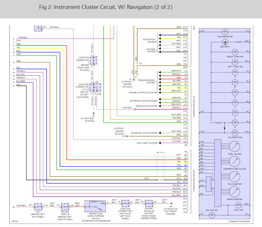

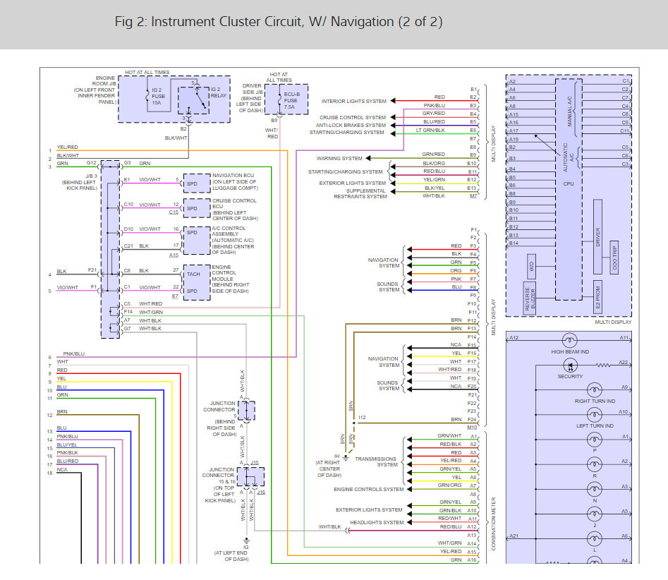

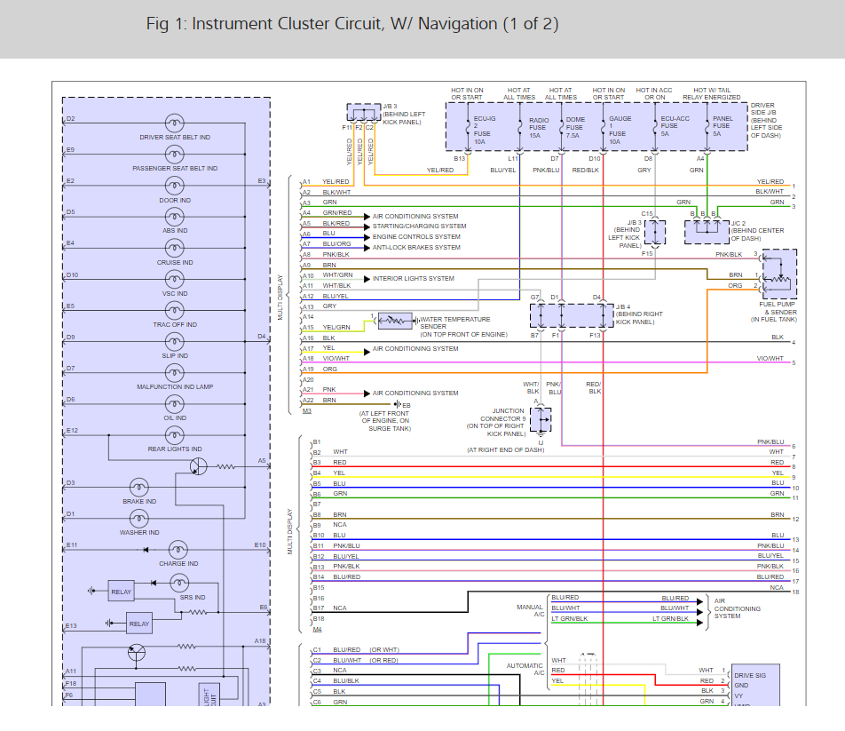

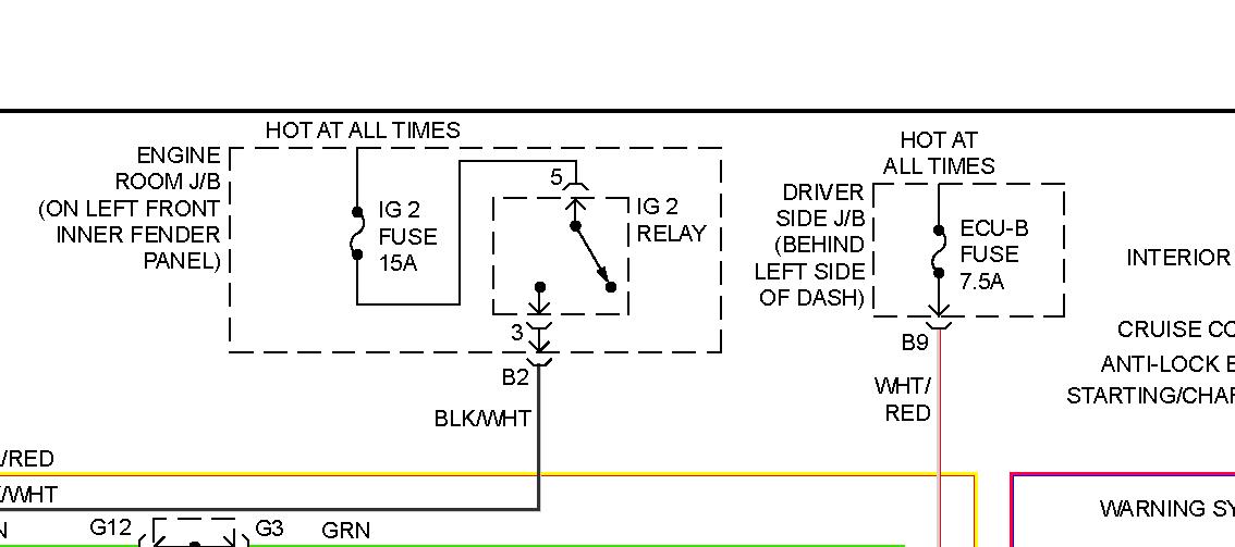

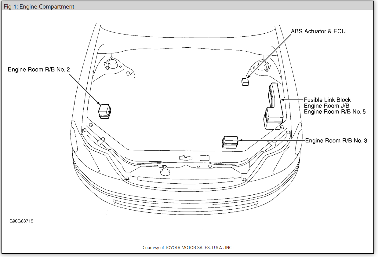

There is a IG2 relay that needs to be checked here is the cluster wiring diagrams so you can see how the system works and a guide to test the relay with the relay location as well below.

Thank you for this post I had this problem and had to replace the cluster FYI

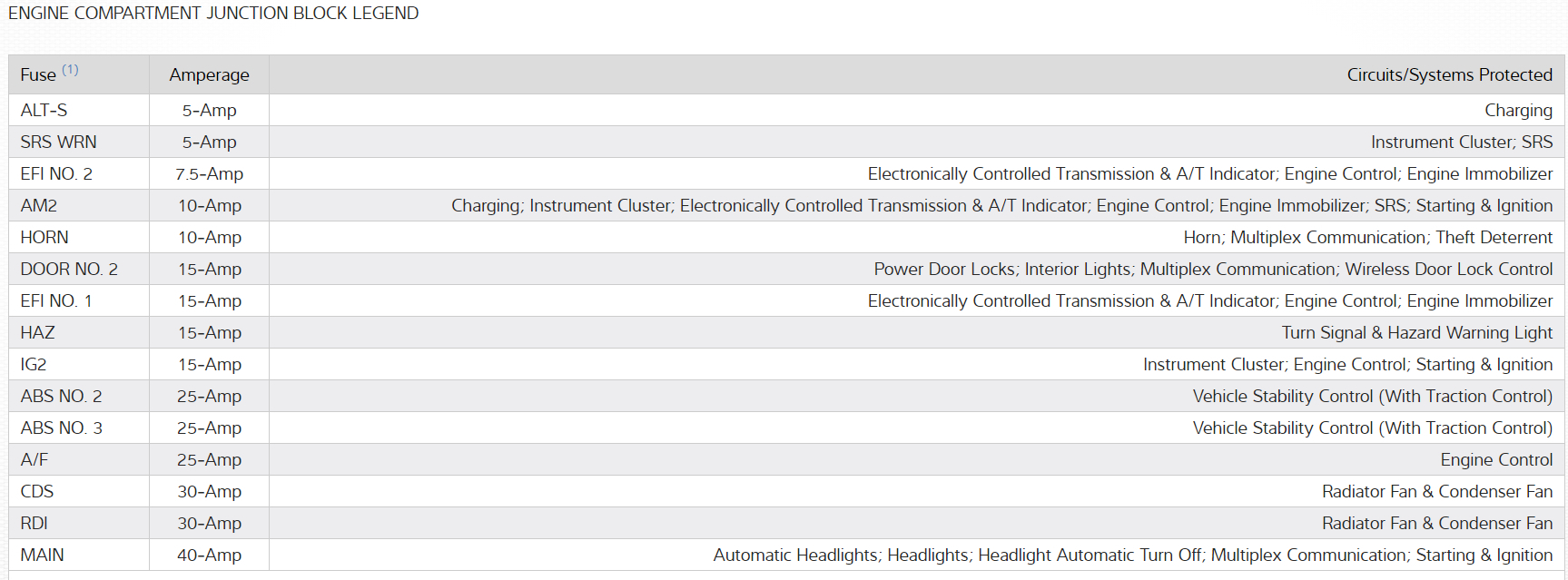

I had to Jump Start my car and since then my car gauges will not operate. ( Engine coolant temp. gauge, Tachometer, Speedometer, Fuel Gauge and the Motor oil pressure.)
Could you help me out with these problems?

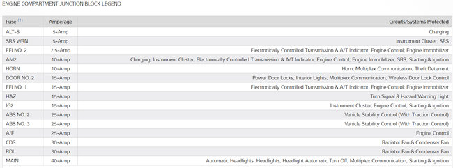

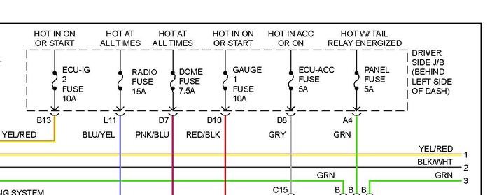

Check the fuses under the hood and inside the car. They often blow from the surge of a jump-start.
Feb 12, 2019 at 11:02 AM (Merged)
ALBERTO VAZQUEZ
I did it. N the problem stil there

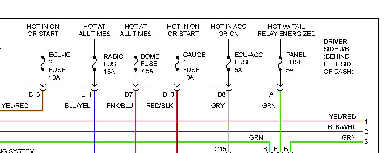

KHLOW2008
  • 41,814 POSTS
These are all the fuses you need to check.
