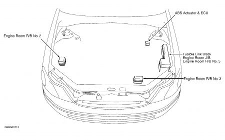

Hi
I get a big trouble with my Toyota Avalon XL 2003. One week ago, the Check Engine Light came on. I went to the Auto-zone store to read the error code . They gave me the code P0135 with the description of O2 Sensor bank 1 sensor 1. I bought a new O2 Sensor bank 1 sensor 1 of them about $216 . Then I replaced it. The Check Engine Light turned off about one night. After that, the light comes on again. What should I do ? I'm confusing with this problem .
thank a lot
Feb 15, 2009 at 5:33 AM
ZACKMAN
  • 4,202 POSTS
P0135 refers to the O2 sensor heater circuit no activity, not necessarily the O2 sensor. The first thing I would check is the relay, located inside the engine room junction box JB.

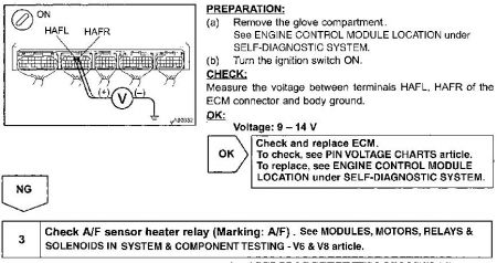

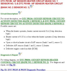

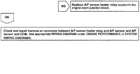

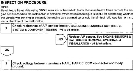

Promise that you won't be mad at me. But the mechanic #1 was right. Bank 1 is the one closer to the fire wall. And mechanic #2 was totally wrong when he said you had to drive 4 cycles to turn the CEL off. It is only 2 trip cycles. He also overcharged you by a bunch. It only tool 0.8 hours of his hourly rate to replace that sensor. Unless his labor rate is 125 per hour. Anyway, you just mis-spent your money. The original CEL codewas P0135 which means A/F Sensor (O2 sensor) heater circuit (Bank 1 Sensor 1). It has to do with the circuit, not the sensor itself. Here is the diagnostic for P0135
