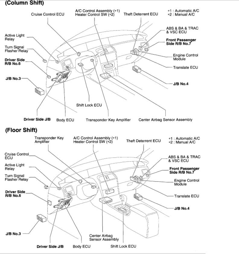

i want to install a new flasher but I can not locate it. I have looked under the drivers side kick panel but I cannot find it. What does it look like? Would help if you could describe where it is

This flasher is located up under the dash on the drivers side near the kick panel. Here is a diagram of its locations (below)
